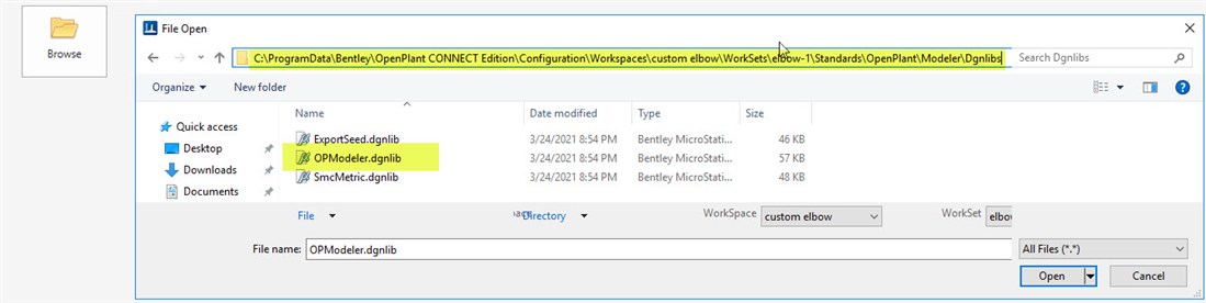

  2. Open the OPModeler.dgnlib from browse button, the path of which is attached below
    C:\ProgramData\Bentley\OpenPlant CONNECT Edition\Configuration\Workspaces\custom elbow\WorkSets\elbow-1\Standards\OpenPlant\Modeler\Dgnlibs

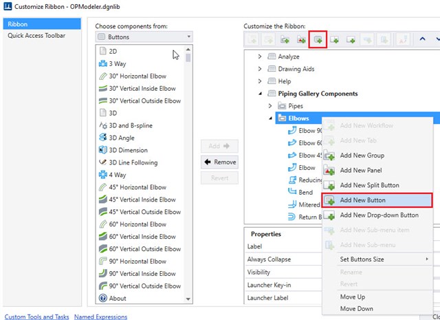

  3. From OpenPlant Modeler CONNECT Edition, right click on white-space of ribbon & select Customize Ribbon
  4. Under Customize Ribbon Dialog, from right hand pane (Customize the Ribbon section). Expand OpenPlant Modeler node and expand Piping Gallery Component node. Further expand Elbows node
  5. Right click on Elbows and select Add New Button or select New Button from the top

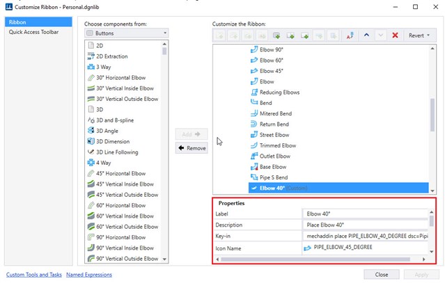

  6. In properties section, set the button's LabelDescription and Icon as required. Set Key-in as mechaddin place EC_CLASS_NAME dsc=Piping. For example, For 40 degree pipe elbow we will set key-in as mechaddin place PIPE_ELBOW_40_DEGREE dsc=Piping
  7. Click Applyand close the dialog
  8. Open dgn file in the same workset and click Elbows from Piping. Scroll to custom class button in component gallery and click to start placement.
    Notice that the button for Elbow 40 degree is added successfully.
