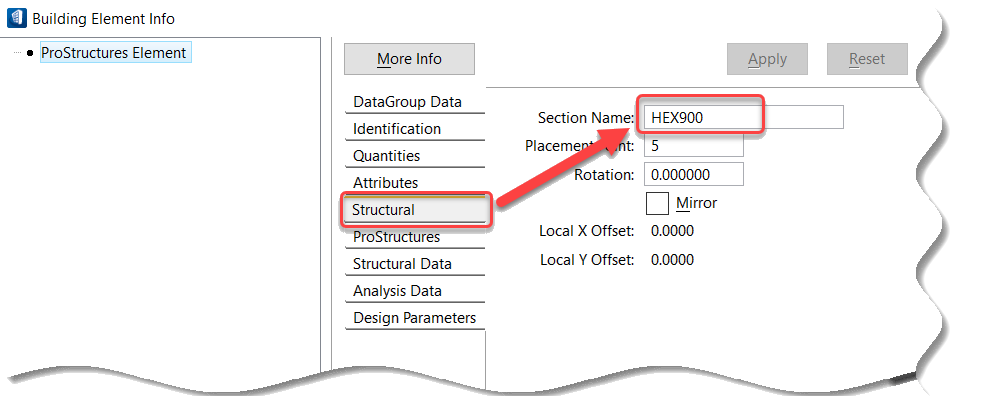

- Select one of the ProStructures elements and find the section name via the "Building Element info" tool.

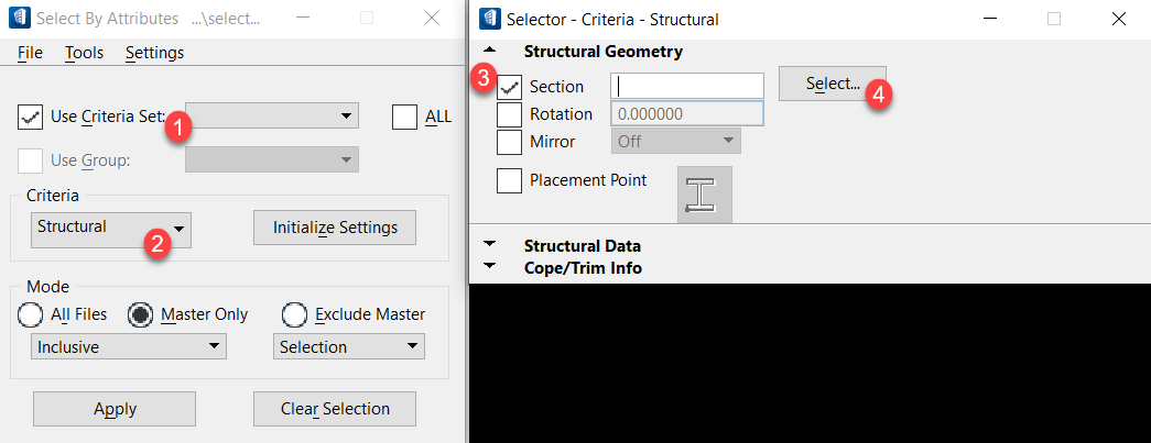

- Go to Select by Attributes.

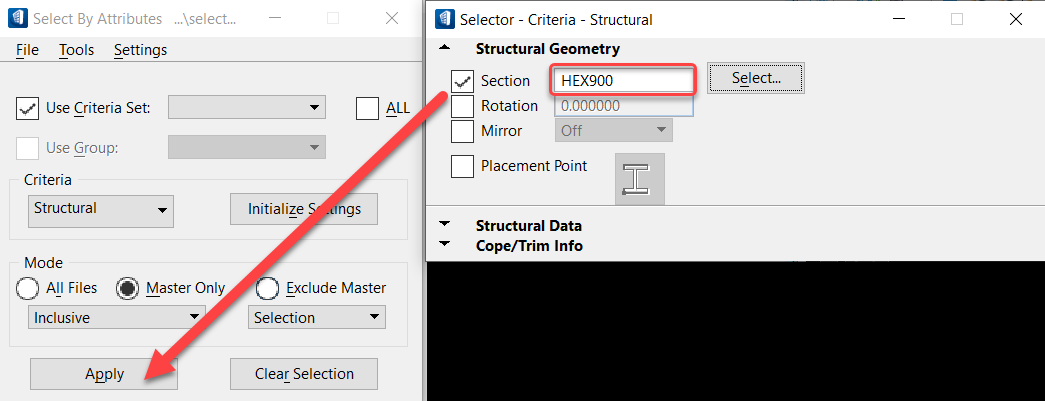

- Select the element according to the Section name under the Structural criteria option.
- Search for this element and Apply. Only the ProStructures elements with this section name will be selected.

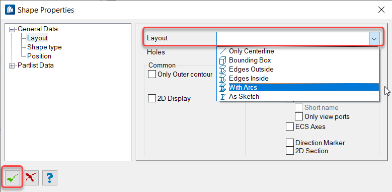

- Now right-click on the element and choose Structural Properties from the pop-up menu, click on Layout in the left pane, and apply the desired Layout. When done, click on the green check mark button.
This allows you to select only ProStructures elements from all existing ProStructures and non-ProStructures elements to assign the desired Layout.
