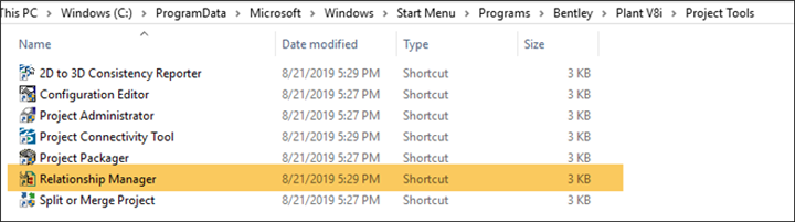

1. Click on Bentley Plant CONNECT icon available on desktop.

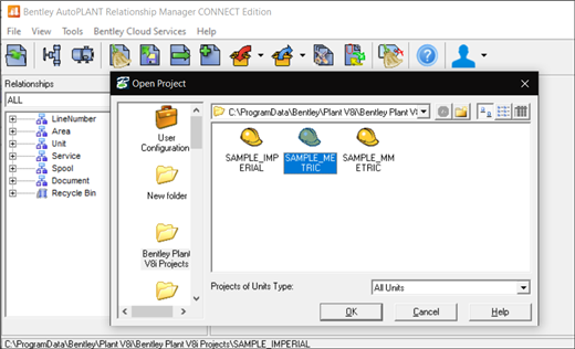

2.To launch Relationship Manager, go to Project Tools and select Relationship Manager.

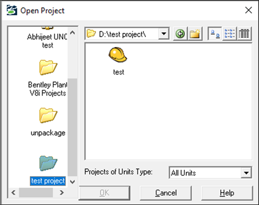

3.Select desired project as per requirement.

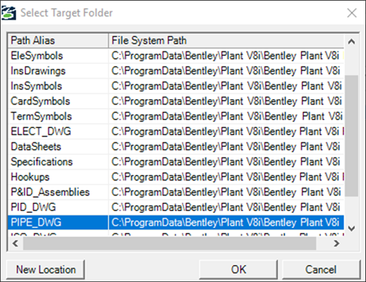

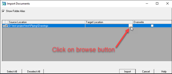

7.The following dialog display
8.Select the target location and click OK. For e.g. for Piping Drawing file PIPE_DWG selected.

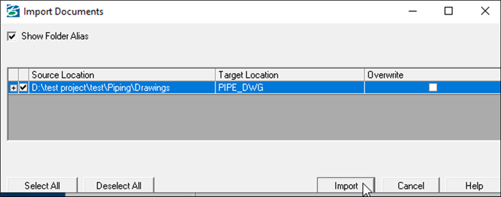

9.Click on Import button to Import the Drawing File from one Project to Another Project.
