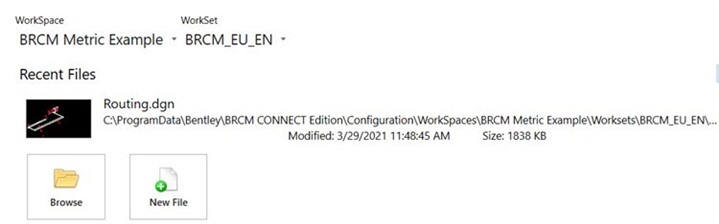

1. Launch the application and open Routing DGN file.
Note: Open an already routed DGN file. For detailed steps to perform automatic routing refer to this link.

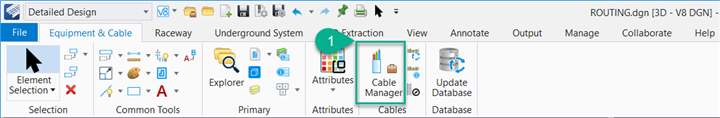

2. In Equipment & Cable tab , open the Cable Manager.

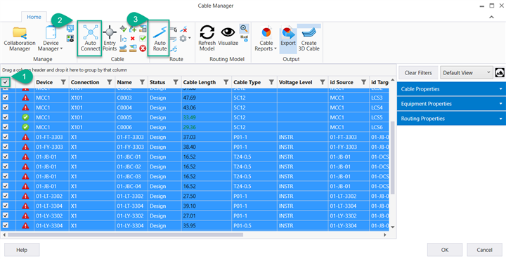

3.In the cable manager, select all the cables and perform automatic routing on the cables.

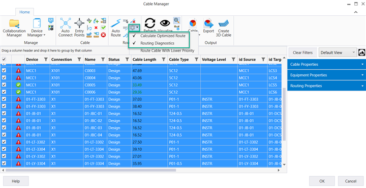

4 From the Route ribbon group in the ribbon menu click on Routing Options and check Calculate Optimized Route and Routing Diagnostics,
click on Automatic Routing to autoroute all the selected cables.

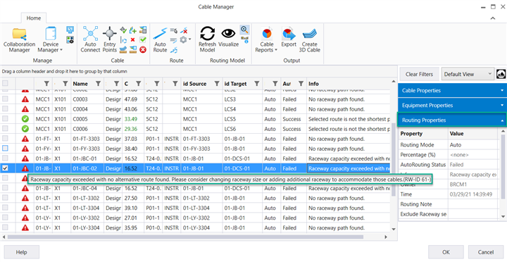

5.After automatic routing gets completed , the info dialog displays the successful and failed cables. Some cables have failed the auto-routing.
6. Click on the cable where auto-routing has failed.
In this instance the auto-routing has failed, and the info property displays the message – ‘Raceway capacity exceeded with no alternative route found. Please consider changing the raceway size or adding additional raceway to accommodate those cables. (RW-ID-61-)’ .
The RW-ID-61 displayed is the Raceway ID responsible for the cable routing failure.
