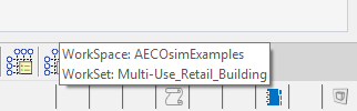

Note that the Active Workset is indicated in the Status Bar:
