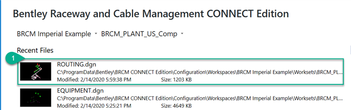

1. Launch the application and open a Routing DGN file.
Note: Open an already routed DGN file. For detailed steps to perform automatic routing refer to this link.

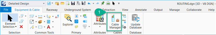

2.Click on References and attach the Raceway.DGN as a reference file. You must attach your raceway model to routing model in order to visualize the path taken through raceway systems.

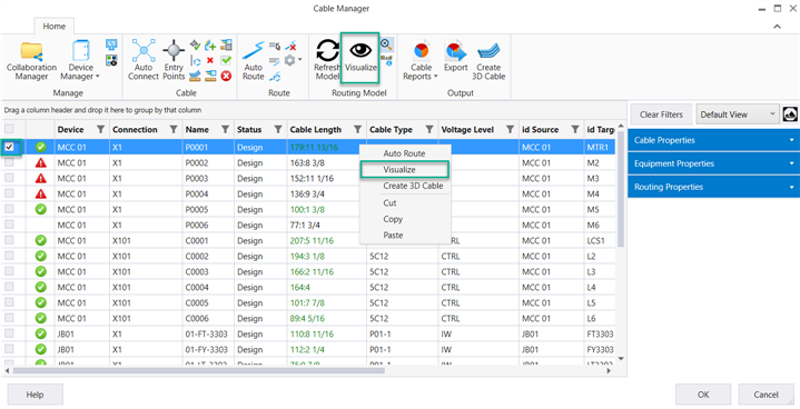

3.Open the Cable Manager and select a cable (i.e. P0001) and right click to visualize the cable or click Visualize from the ribbon menu.

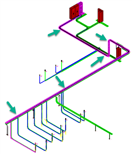

4.After visualization, the raceway through which the cable passes is highlighted in magenta.
