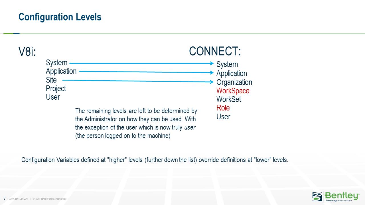

Additional configuration levels
CONNECT Edition has two additional configuration levels :
Further explanation of these can be found in the delivered help:
Home > Setting Up the Environment > Configuration > Configuration Concepts

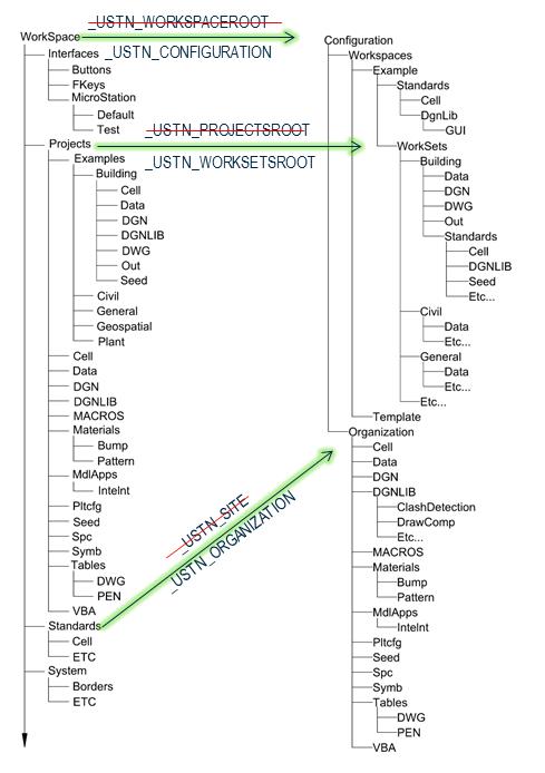

Folder comparison and variable name changes
Below is a comparison of the delivered directory structure and some of the configuration variables that are most commonly worked with:
      V8i                                                  CONNECT Edition
NOTE: Pre-CONNECT Edition variables are struck through and the variables listed below the arrows are the CONNECT Edition equivalents.

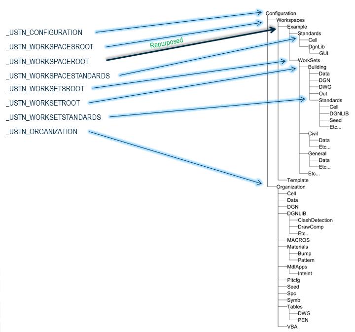

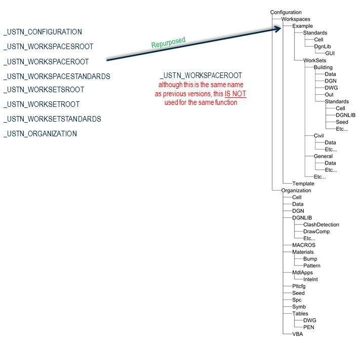

_USTN_WORKSPACEROOT is now used to define the root directory of a specific Workspace:
Some new CONNECT configuration variables
Here are some of the new configuration variables and their resulting folders in the new directory structure:

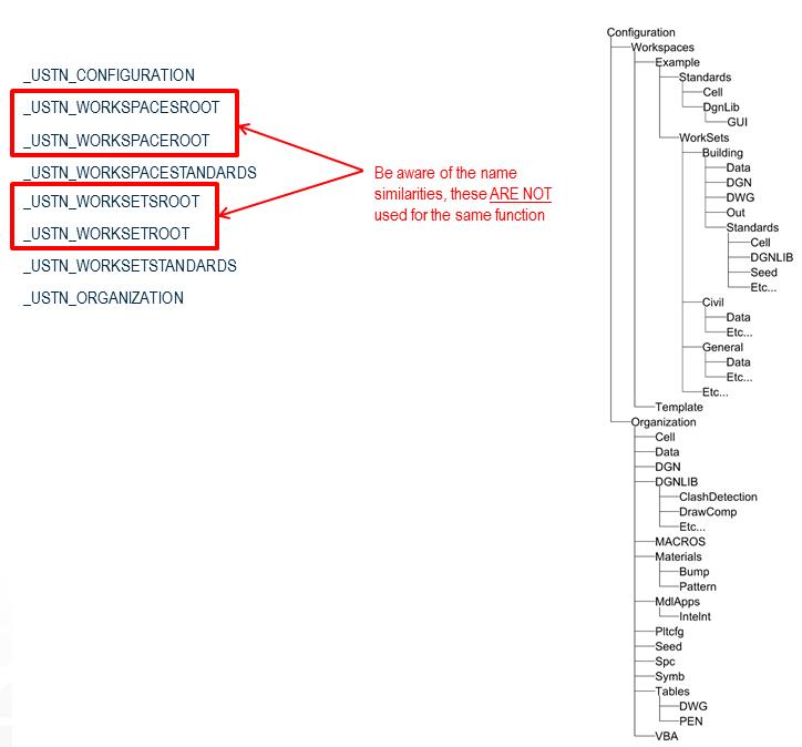

Something to be aware of with the new variables is the similarity between two sets of variables:
 _USTN_WORKSPACEROOT and _USTN_WORKSPACESROOT      (notice the extra “S”)
_USTN_WORKSETROOT and _USTN_WORKSETSROOT                  (notice the extra “S”)
