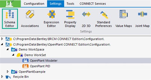

  1. Launch OpenPlant Project Administrator CONNECT Edition Update 9.
  2. Select application icon from desired workset and click on Schema Editor, refer image below.

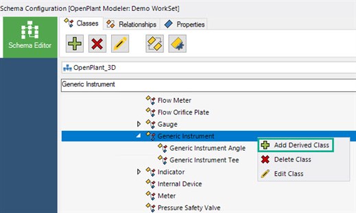

  3. From Schema Configuration dialog, search for Generic Instrument. Right click on Generic Instrument and select Add Derived Class, refer image as shown below.

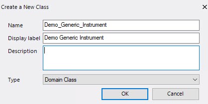

  4. Enter desired class name and click on OK.

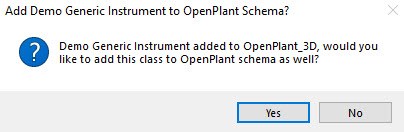

  5. Notice that upon OK, application prompts message for addition of same class in OpenPlant schema. Click on Yes. This will include (add) the same class to OpenPlant schema as well.

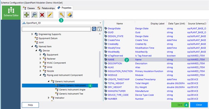

  6. Select newly added class, select NAME property, and click on Mark as Business key.

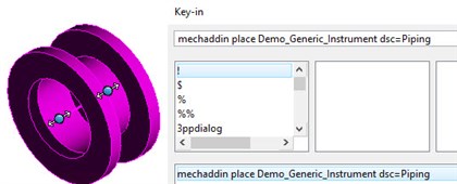

  7. Save all the schema changes, load OpenPlant Modeler Connect and confirm placement.
    Note: In selected specification, record for added class must be available for its placement.
