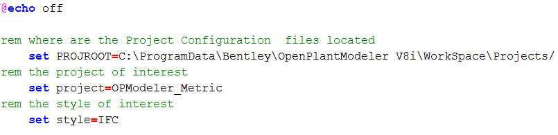

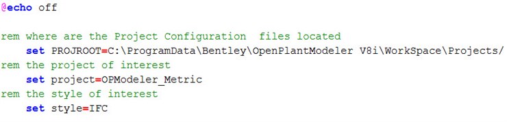

  4. Set Project Root as mentioned below for default project here.
    set PROJROOT=C:\ProgramData\Bentley\OpenPlantModeler V8i\WorkSpace\Projects/
    set Project=OPModeler_Metric
  5. Set Style as desired, Say IFC here. See image below.
  6. Save & Close file.

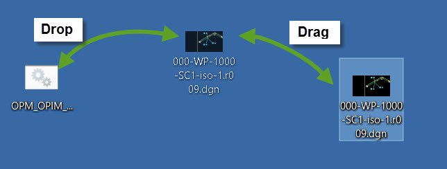

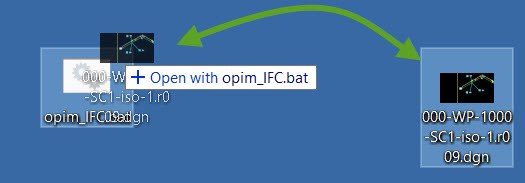

  7. Navigate to folder where isometrics drawings gets generated.
  8. Select the isometrics and drag the DGN file from its folder and drop it on specified BAT file which has its corresponding Styles and Project Root.
    Note This will take few seconds to generate isometric drawings.

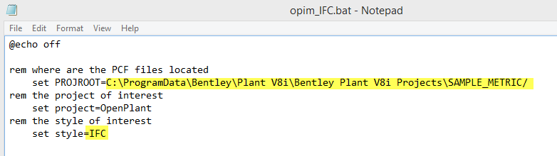

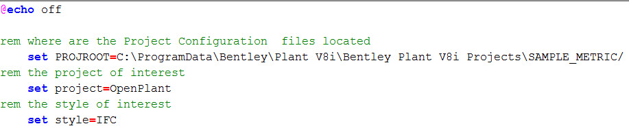

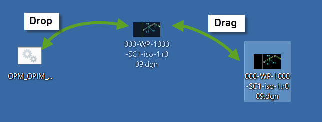

    set PROJROOT=C:\ProgramData\Bentley\Plant V8i\Bentley Plant V8i Projects\SAMPLE_METRIC/
