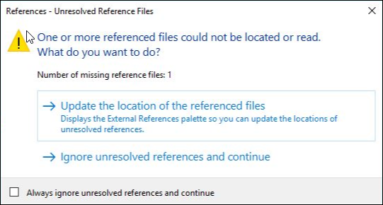

In OpenPlant Isometrics Manager, when open DWG mode isometric in AutoCAD  user may encountered References-Unresolved Reference files error.
Problem description
When isometrics are generated in DWG format using OpenPlant Isometrics Manager sometimes it shows up unresolved XREF in a message when opening the ISO DWG file.
Following descriptive steps helps to rectify above image error.

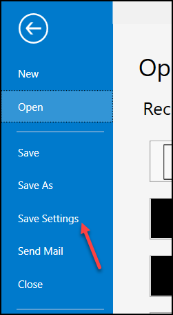

4. Go to File > Save settings
