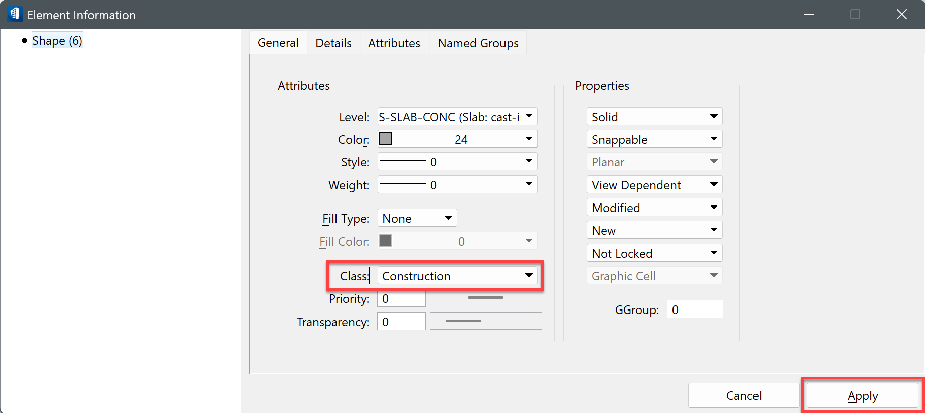

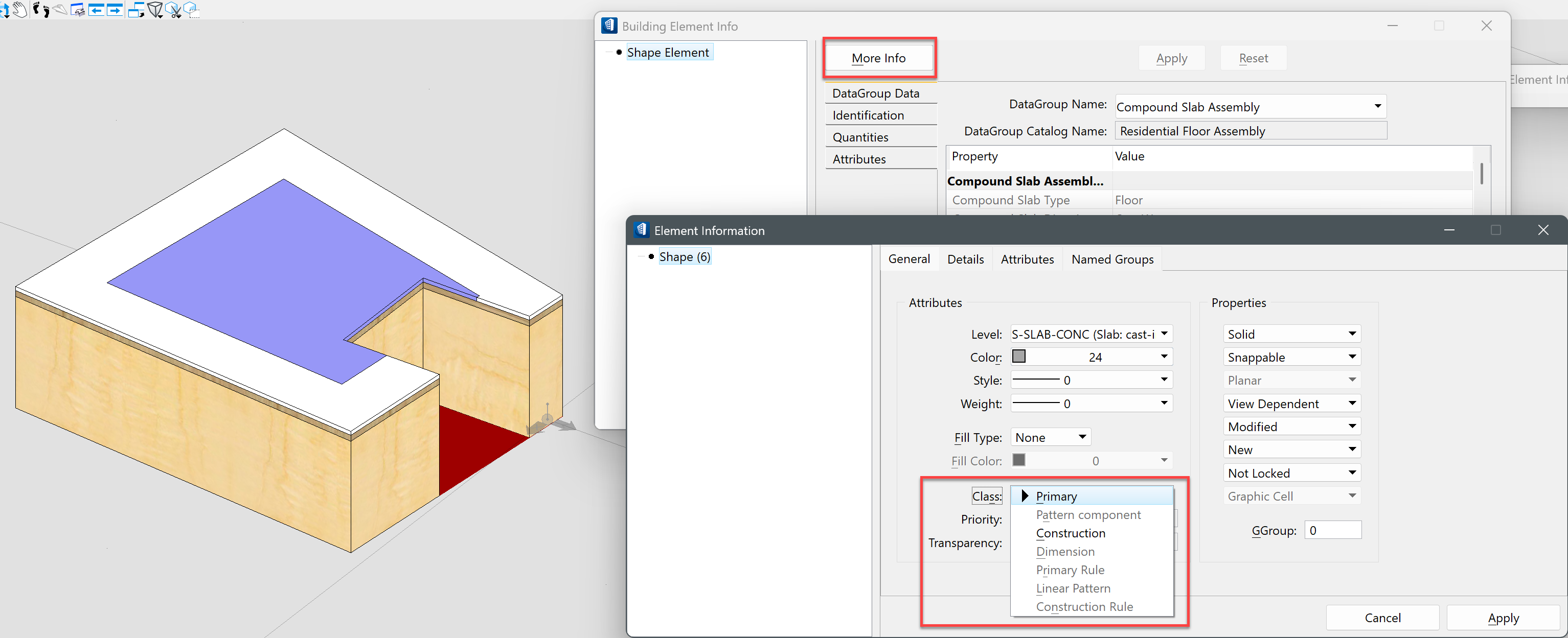

If you prefer to change the Base Region to Construction class manually, you can do so using the Building Element Info tool:
- Select the Base Region with the Building Element Info tool, click on the More Info button, then click on the Class drop-down list:
- Change the class from Primary to Construction and click on the Apply button:

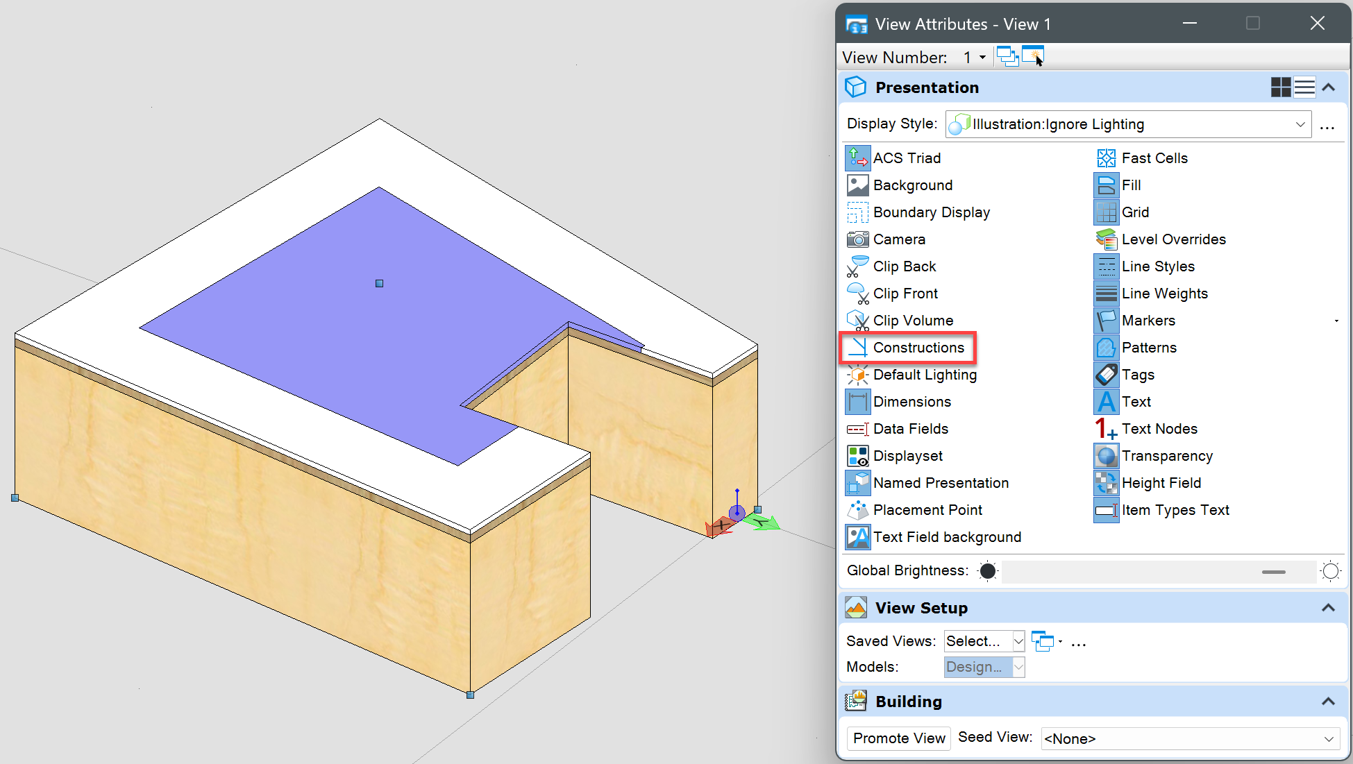

- As long as Constructions are disabled in View Attributes, the Base Region will not be displayed:
