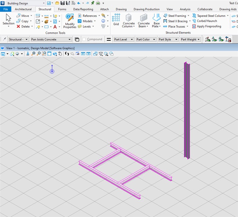

  1. Select the required ProStructures member(s).

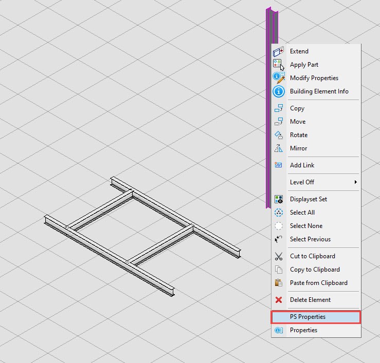

  2. Using a long mouse right-click, select PS Properties / Structural Properties:

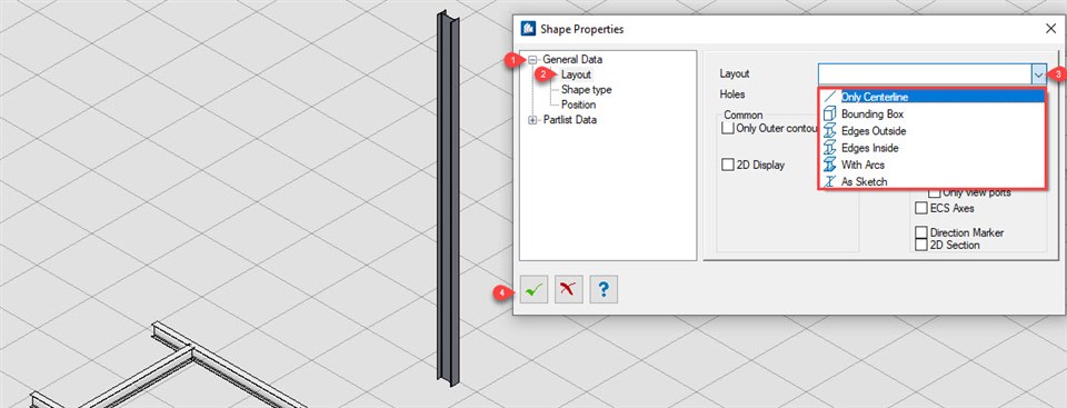

  3. In the Shape Properties dialog box choose General > Layout > Layout drop-down and select the desired layout option. Then accept the changes by clicking on the green colored tick ( ).

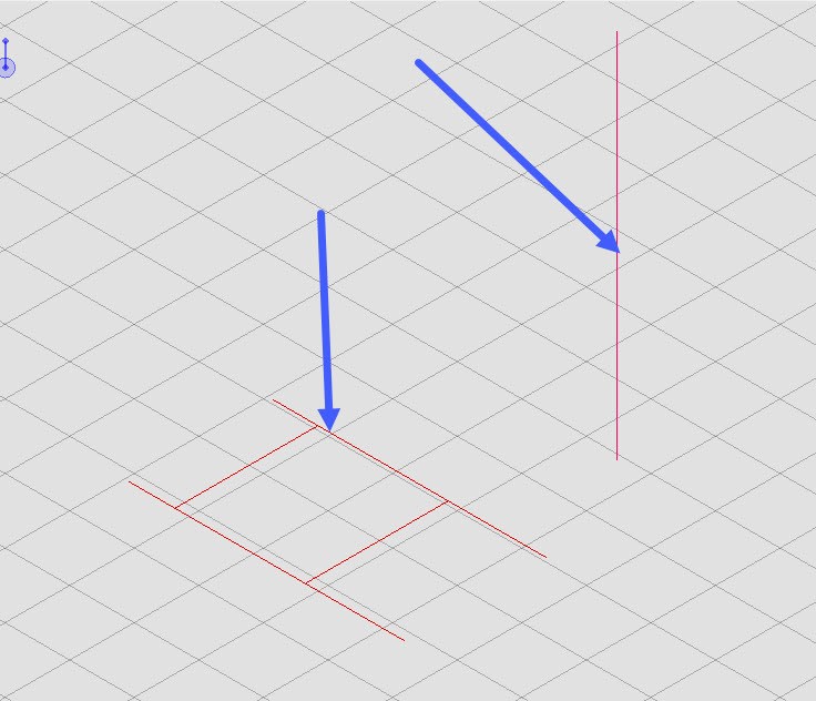

  4. The changes of layout for the elements will be visible in the model.
