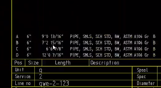

This wiki will be helpful in case of configuring Dummy Leg Support- getting a new symbol, in BOM and eliminating it from Cut-ID.

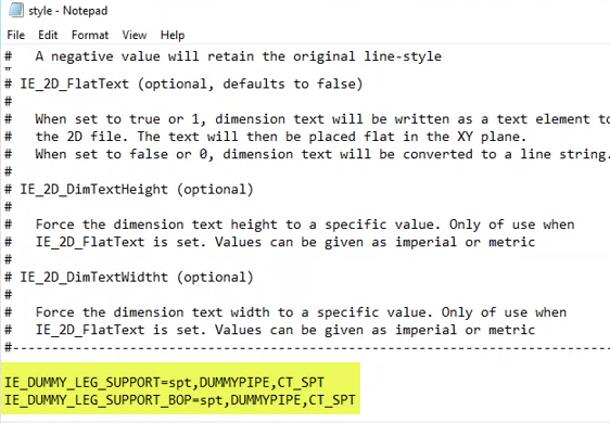

1. In your preferred “Style.cfg” file of the concerned Project, edit as highlighted below at the very bottom.
[ IE_DUMMY_LEG_SUPPORT=spt,DUMMYPIPE,CT_SPT and IE_DUMMY_LEG_SUPPORT_BOP=spt,DUMMYPIPE,CT_SPT ]

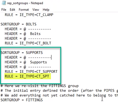

2. Add new IE_TYPE in “rep_sortgroups.txt” as shown below.
[ RULE = IE_TYPE+CT_SPT ]

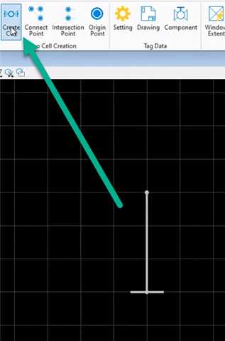

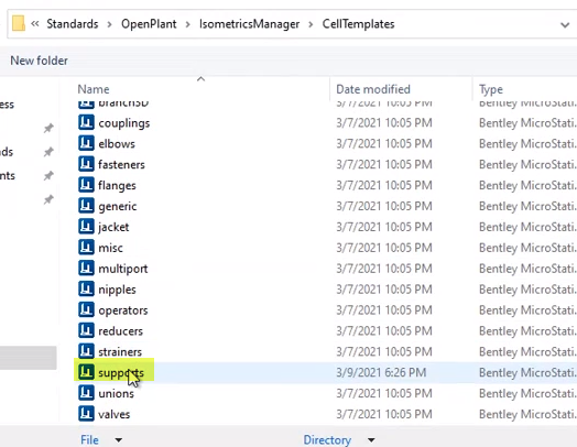

3. Create a new symbol cell for your Dummy Leg.

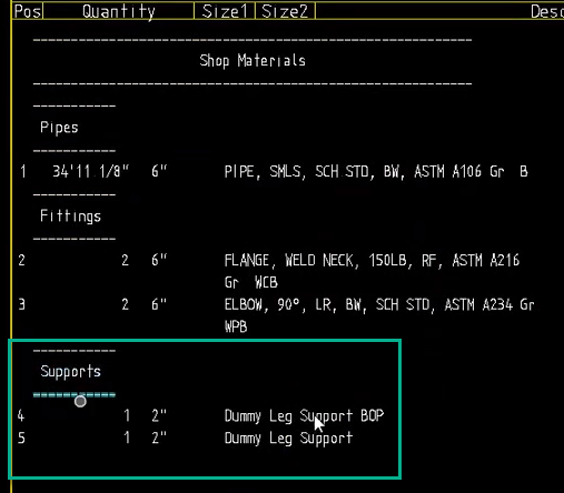

4. Now Generate Iso to get desired result.
