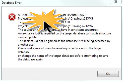

ATDB0312: Database error the source and target databases have inconsistent structures
Product(s):AutoPLANT Modeler CONNECT Edition
Version(s):10.02.XX.XXX
Environment: Windows 10 (64 bit)
Area: Errors, Logs, Messages, Crashes
Subarea:
Original Author:
Dinesh Solanki, Bentley Technical Support Group
Database error is shown while opening/creating model in SQL distributed project using AutoPLANT Modeler CONNECT Edition.
Problem Description
Database error are observed while opening/creating model in SQL distributed mode projects
1. Create a SQL distributed mode project
2. Create model in the project Save and re-open the model

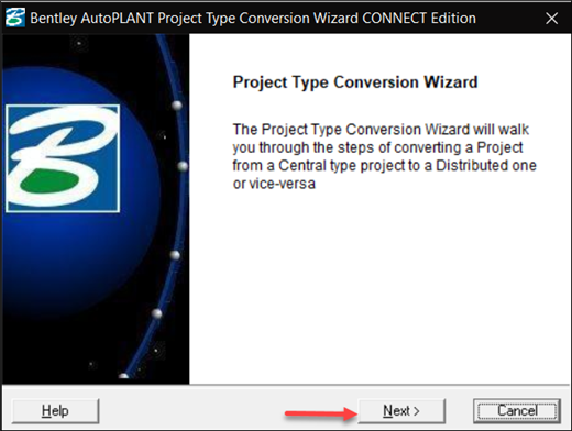

Steps to Resolve
Converting the Project Mode to Central Mode will  resolves the issue
1. Open Project Administrator-->Tools-->Project Conversion Wizard
2.Change project type to Central type project using the wizard.
3. Now, re-open the model to see that the issue has been solved.
