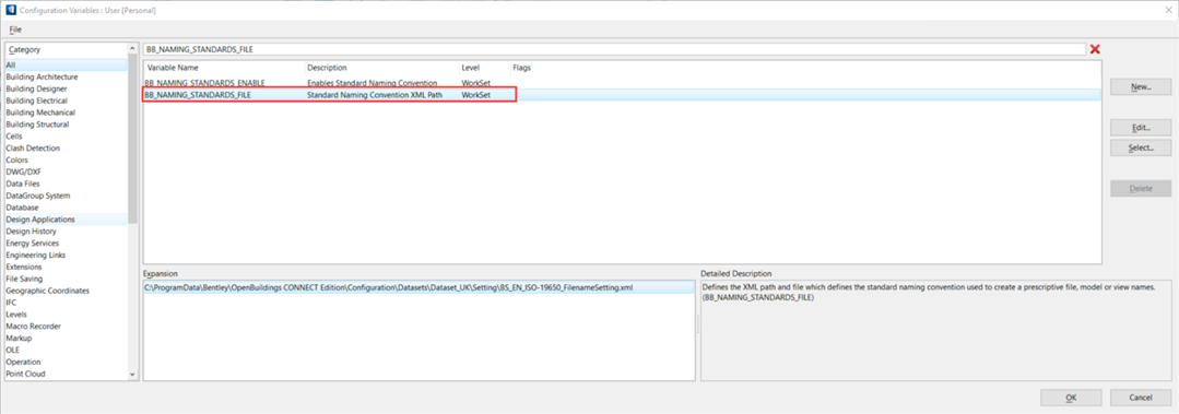

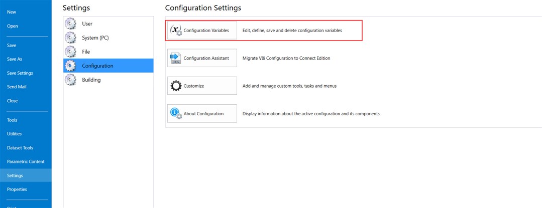

  1. Open the Configuration Variables dialog box from the backstage (File > Settings>Configuration > Configuration Variables) and check the variable BB_NAMING_STANDARDS_FILE which defines the XML path and file for the currently used standard naming convention. For example, in the UK dataset it points to the folder "C:\ProgramData\Bentley\OpenBuildings CONNECT Edition\Configuration\Datasets\Dataset_UK\Setting" and the name of the file is BS_EN_ISO-19650_FilenameSetting.xml

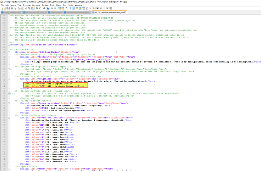

  1. Then in the BS_EN_ISO-19650_FilenameSetting.xml file we will define the <Attr> value which displays the property visible in a panel at the bottom of the SFN Utility identifier for the following sub-nodes: File naming, Model naming, Design Model naming, Drawing Model naming, Sheet Model naming, Saved view Naming.
 If you want to change the identifier for each organization then follow the below scripts:
           <Attr Value="Organization short description" > Organization short description – Full name of the organization</Attr>
Let’s say "National Highways" is the name of the organization and "LTC" is the short description, then we will add the line below:
            <Attr Value="LTC" >LTC - National Highways</Attr>

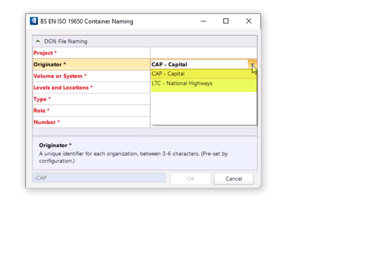

  1. After doing the above modification, we can see that Originator field is displaying the desired organization code.
