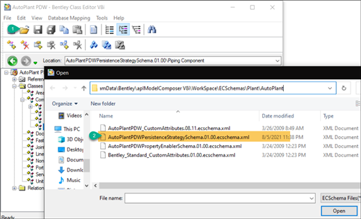

1.Open Bentley Class editor V8i
2.Open the AutoPlantPDWPersistenceStrategySchema.01.00.ecschema.xml from the below directory.
C:\ProgramData\Bentley\imodelComposer V8i\Workspace\Ecschema\Plant\AutoPLANT

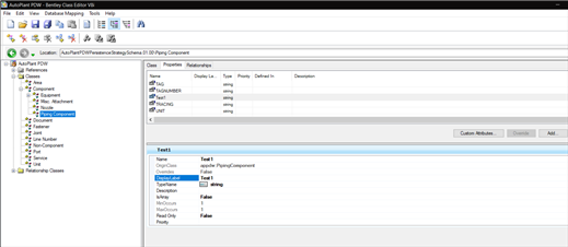

3.New attribute should be added in Piping Component.
4.Give the Name TEST1. (As per your requirement)

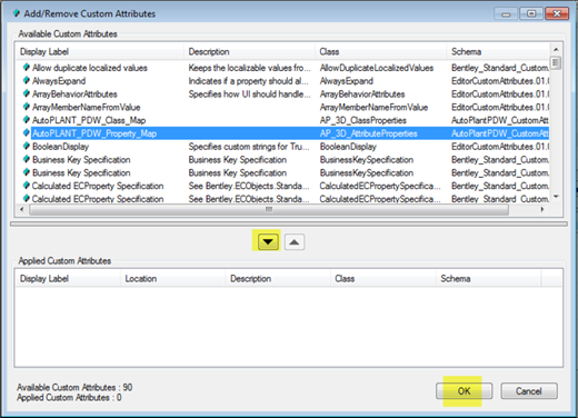

5.Add custom Attributes AutoPLANT_PDW_Property_Map

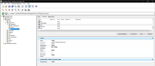

6.Define the AutoPLANT Property under AutoPLANT_PDW_Property_Map
7.Save the schema.
8.Now open model in Bentley I-model composer and model will start showing the property in AutoPLANT I-Model Composer.
