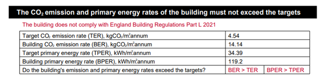

The major effects of this for energy assessors and for building compliance can best be seen by inspecting the 2021 BRUKL Compliance documents.
Details
The main changes to expect include:
Target Primary Energy Rate
Previously buildings achieved an overall pass upon considering CO2 emissions levels only, in the form of the BER (Building Emission Rate) and TER (Target Emission Rate). In addition to this, the energy of buildings is now measured via the BPER (Building Primary Energy Rate) and TPER (Target Primary Energy Rate). Both these targets must not be exceeded for a building to comply with the regulations.

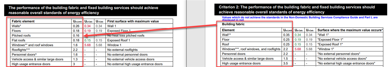

Building Fabric U-value Check
Significantly lower minimum U-values for all building fabric types are to be adopted. This will require much improved building fabric materials, and more insulation.
To put this in context, for Walls the new standards will reduce the target U-value by approximately 25%.
Also note that Roofs are now subdivided into Flat Roofs and Pitched Roofs, each with their own U-value target.

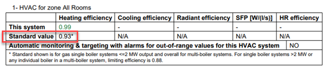

New Minimum HVAC Efficiencies
The exact change will depend on the HVAC System Type selected, however for instance, for conventional boilers the minimum efficiency has changed from 0.91 to 0.93:
