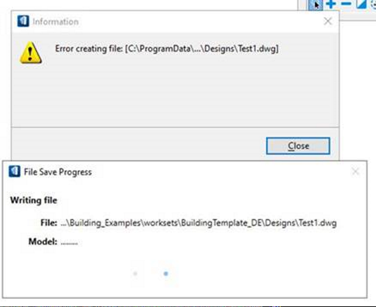

When using the delivered Designseed.dgn from the Dataset_DE, Dataset_DK or Dataset_ISO19650 datasets, a DWG file can't be exported. It gives an error message:
All the DGNLibs have duplicate Line Style definitions which cause this error message to appear. Hence it's necessary to compress all the Dgnlibs and the Designseed.dgn file with the options 'Building Dataset Elements' and 'Unused LineStyles'.
Please Note: This problem only applies to OpenBuildings Designer Update 7 and 8 and is planned to be fixed in Update 9.

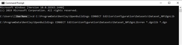

2. Change the file extension of all the *.dgnlib files to *.dgn using a Command Prompt (cmd).

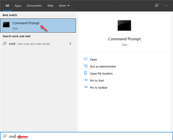

   i) Command Prompt can be started from windows
   ii) The Folder paths outlined in Step 1 should be applied in Command Prompt dialog using the "cd" command. Then type the following command in the next line of the Cmd dialog: ren *.dgnlib *.dgn

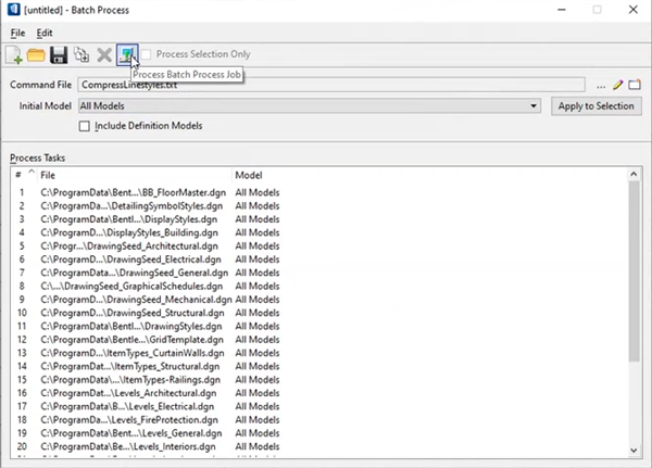

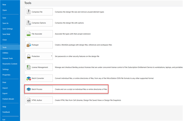

4. From the Back Stage go to Tools> Batch Process and run the batch process to compress all the modified DGNlib files. Do this for all the files except the LineStyle.dgn.
5. Before running the Batch Process, toggle on 'Building Dataset Elements' and 'Unused Line Styles' from Compress Options.
   **DO NOT check the option 'include reference**
NOTE: If you are running the Batch process in MicroStation, Building Dataset Element will not be available in Compress Options.

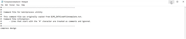

6. Create a new command file with .txt as an extension
7. In the .txt file give the Key-in as "compress design" and hit on save button before closing it.
8. Start the Batch Process
