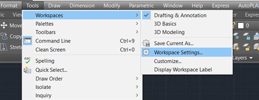

7. Go to the menu Tools>Workspaces>Workspace Settings.

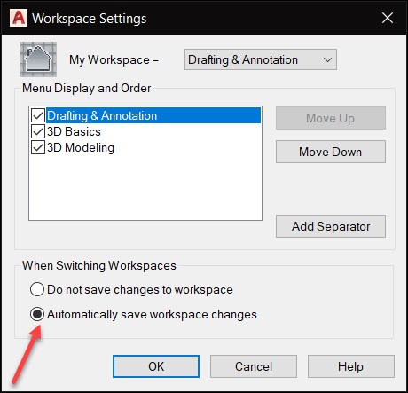

8. In the next dialog check on the option “Automatically save workspace changings".
9. Click on OK to close this dialog.
