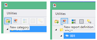

2. From the Reports dialog create a new Category (if needed) and a new Report.

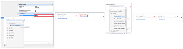

3. With the new report highlighted, select your custom DataGroup Catalog Item and the Item Type Asset_Info from OpenRail Designer.

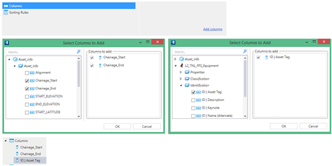

4. Click on the Add Columns link to add the Chainage_Start and Chainage_End properties from Asset_Info and the Asset ID property from your DataGroup Catalog Item.
