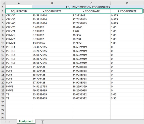

Equipment list is a excel spreadsheet containing the equipment IDs and their co-ordinates.

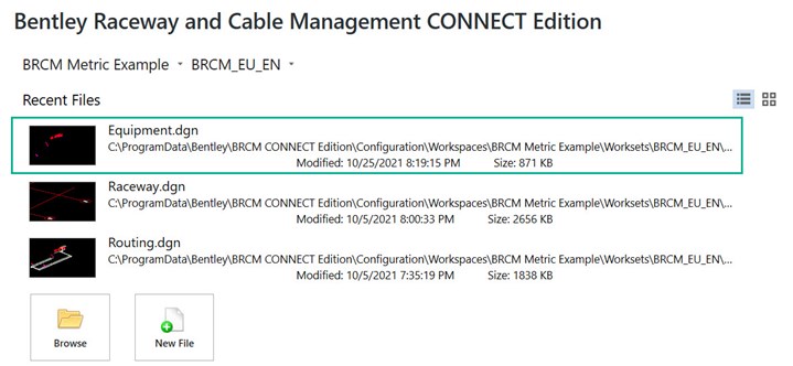

1. Launch the application and open Equipment DGN file.

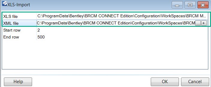

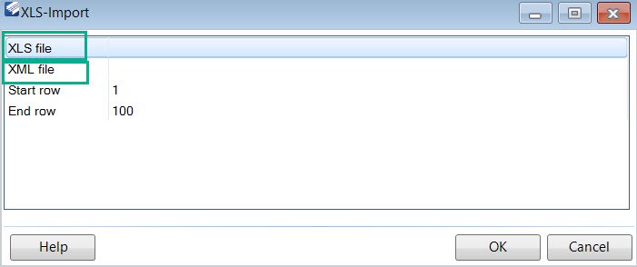

3..In the equipment import dialog the location of equipment list excel (.XLS) file and the mapping (.XML) file needs to be specified which will be used for import.
4. Select the equipment list excel file and its corresponding mapping file.

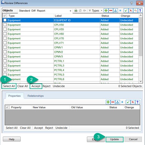

5.Click OK to proceed with the import process. A review differences dialog will be displayed containing the equipment Ids that will be imported.
Click on Select All and Accept the all the equipment for import. Click Update to proceed with the import process.

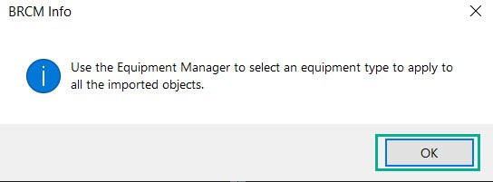

6. An information message will be displayed mentioning to select an equipment type for the imported equipment using the Equipment Manager. Click OK to proceed.
