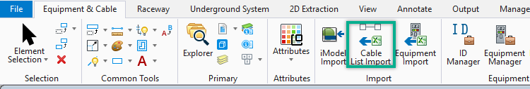

  2. From the Equipment & Cable ribbon tab, select Cable List Import.

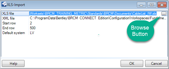

    CableList_Power.xls: XLS file (XLS file contains the cable data that will be imported)
    IMPORT_CableList_Power.xml: XML file (XML file is an import configuration & column mapping file.
  3. In the XLS-Import dialog, set the following file fields using the Browse button. Press OK.

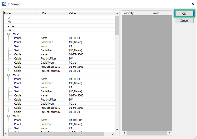

  4. The XLS-Import dialog will be populated with same data as below image.
    Select OK to proceed to next step in the import process.

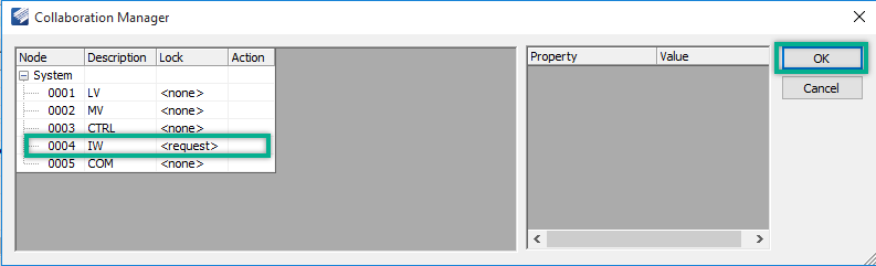

  5. Collaboration Manager opens and a request lock is automatically applied to Voltage/Routing Levels found in the import file.
    Select OK to proceed to next step.

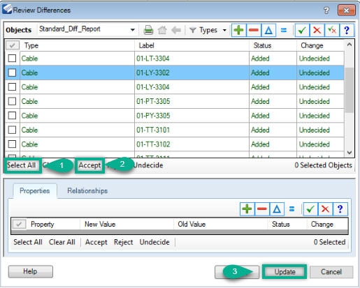

  6. Items available for import will appear in the Review Differences dialog.
    Select items to import using Select All, then select Accept to set Change column value to Accepted.
  7. Select Update to complete the import process.
