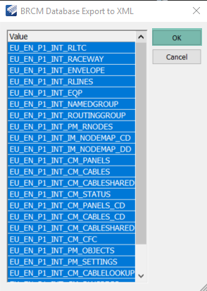

It’s always a good idea to create a backup of the existing database information prior to deleting any data tables. To create the backup follow these steps:
1. Open Bentley Raceway and Cable Management CONNECT Edition.
2. Click on Manage tab and select Export to XML.

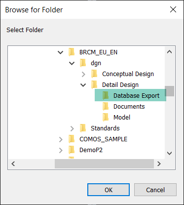

3. Select folder to save the XML files and click OK.
4. Select all the values and click OK.

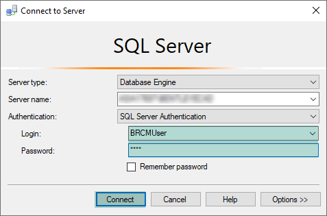

5. Open Microsoft SQL Server Management Studio.
6. Enter BRCM database login credentials to coonect to the server. Click Connect.
Note: You can see the login credential details and the database ID for the respective project in the BRCM.cfg file.
For Example: For the BRCM_EU_EN project of BRCM Metric Example Workspace: Open BRCM.cfg file which is located at C:\ProgramData\Bentley\BRCM CONNECT Edition\Configuration\Workspaces\BRCM Metric Example\Worksets\BRCM_EU_EN\Standards\BRCM

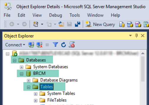

7. In the object explorer, expand Databases >> BRCM >> Tables.

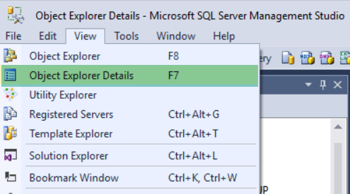

8. Click on View tab and select object explorer details to see all the table details.

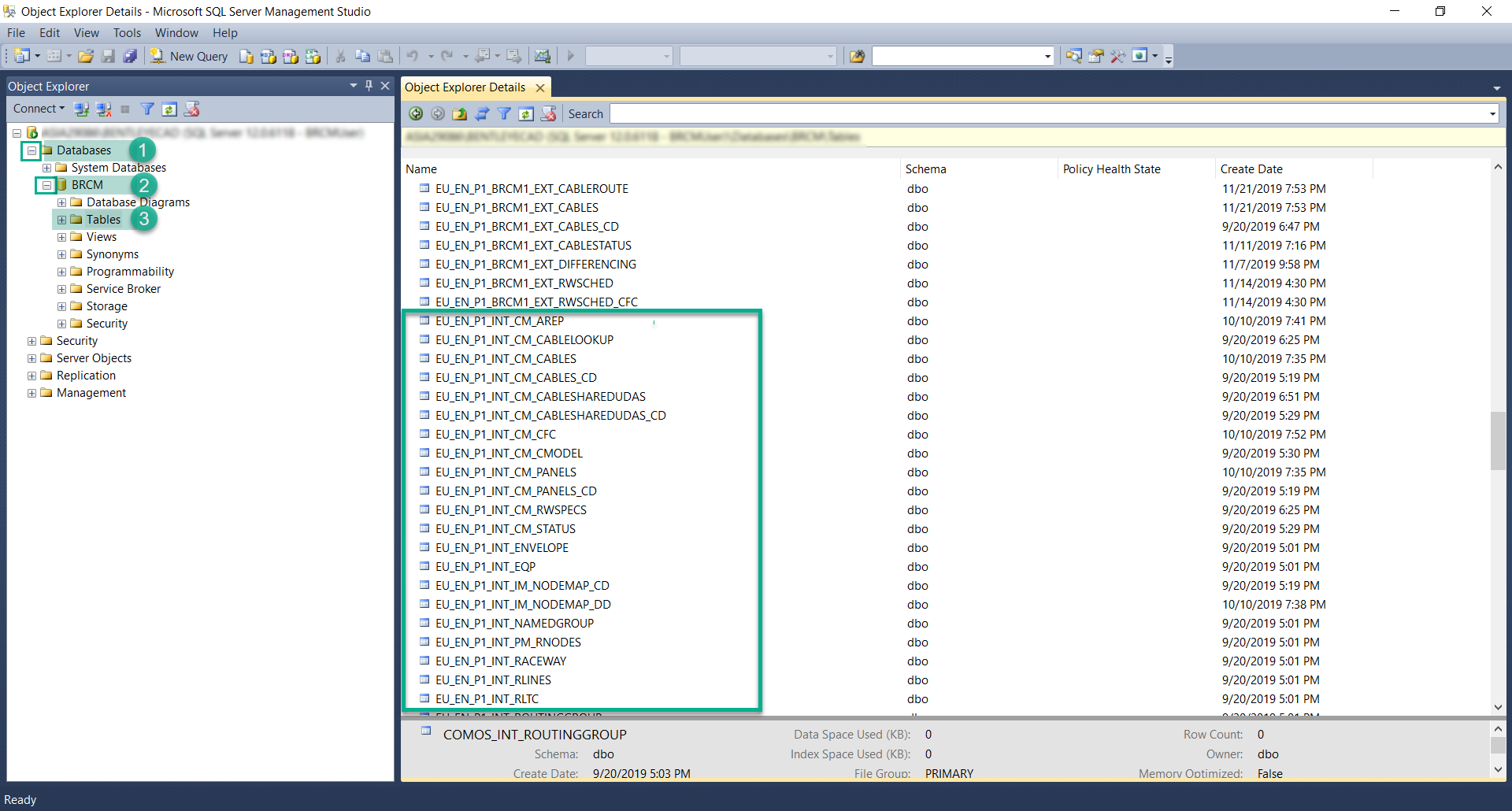

9. In the object explorer details window, you will get list of tables related to respective projects as per the BRCM database ID name. For Example for BRCM_EU_EN project BRCM_DB_ID is EU_EN_P1 as shown below:
10. If you want to delete the imported cable data, select the table which is associated with the cable and delete this tables by right mouse click. Similarly, you can delete the imported data in the project for the equipment.
11. The tables will be recreated after you import the data again.
