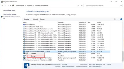

A Desktop Shortcut to > OpenBuildings Designer is not installed by default, one can be added by running the installer with the Change option.
  1. If the application is already installed, go to Control Panel, right mouse click on the application and pick Change.

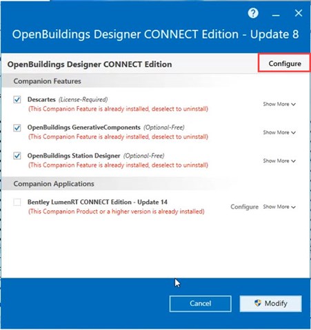

  2. Click on Configure.

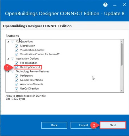

  3. Check on the Desktop Shortcut option and click on Next.

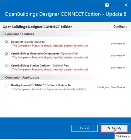

  1. Click on the Modify.
  1. The shortcut will appear on the desktop.

If a Desktop Shortcut is required when installing the application for the first time, tick the Desktop Shortcut box shown in Step 2.
