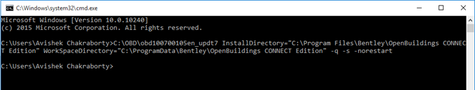

  3. From the Windows start menu, open a Command Prompt as shown:
  4. In the command prompt dialog paste the below path/text and press enter.
    C:\OBD\obd100700105en_updt7 InstallDirectory="C:\Program Files\Bentley\OpenBuildings CONNECT Edition" WorkSpaceDirectory="C:\ProgramData\Bentley\OpenBuildings CONNECT Edition" -q -s -norestart

  5. Please ensure that while entering the command, the name of the installer is the same as the setup file name. For example, the setup file name above is: obd100700105en_updt7. If it’s something different then the command will change according the setup file name.
