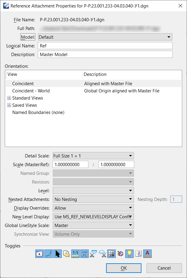

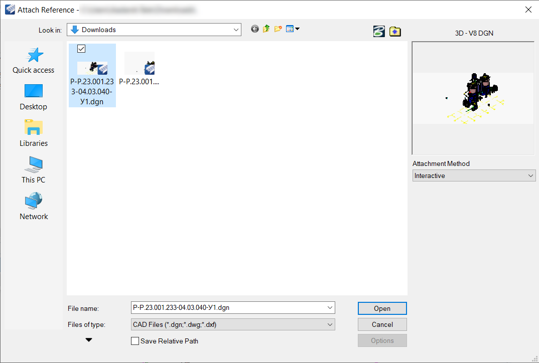

  2. Attach the reference DGN from OpenPlant Modeler CE 2 as shown below.

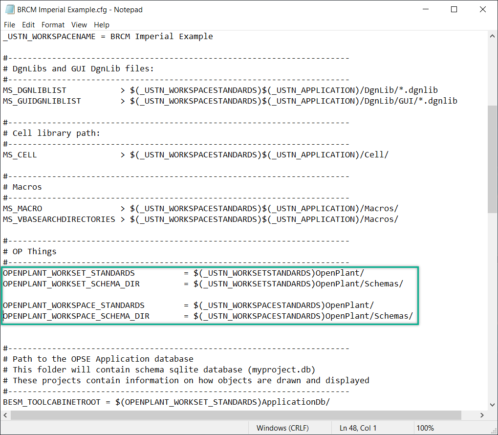

    Open Settings and select Configuration, then click About Configuration for viewing current DGN file details.
  7. User need to check the Workspace configuration file for the Workspace on which the modeling is done. For example: BRCM Imperial Example.
  8. In the configuration file, Search OpenPlant standards and schemas for Workspace and Workset.

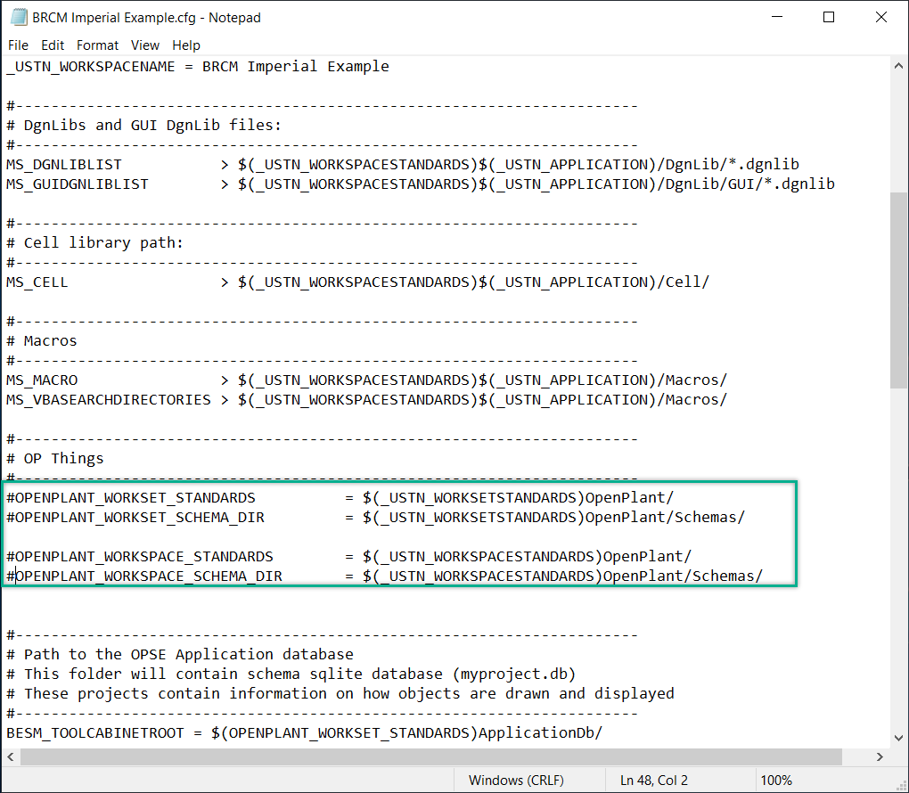

    Disable them by adding “#” as shown below.
    File location: C:\ProgramData\Bentley\BRCM CONNECT Edition\Configuration\Workspaces\BRCM Imperial Example\Worksets.
  9. Close the configuration file and launch BRCM. Now open the Project Explorer and look for details in Items.
