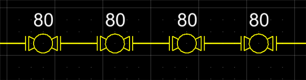

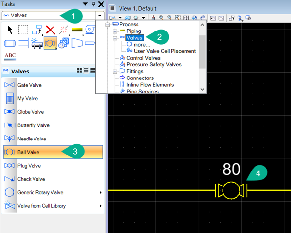

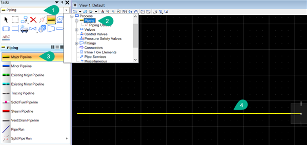

  2. Place a Pipeline. Place ball valves on the pipeline.

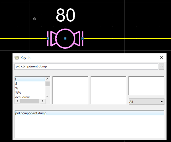

  3. Select valve and Open Key-in window. You can open key-in by any of the following
    a. Utilities > Key-in
    b. Help > Key-in Browser

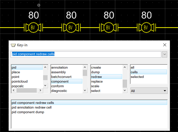

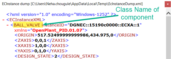

    • Enter Key-in – pid component dump and enter. You can find class name, cell name, cell library of selected valve as shown in below images.

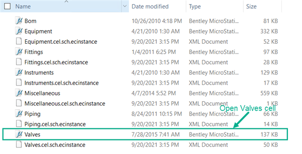

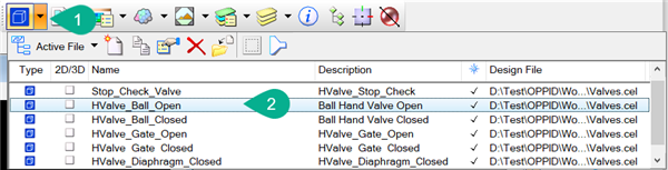

    • Open Valves.cel from the mentioned file location.
      C:\ProgramData\Bentley\OpenPlantPID (SS10)\WorkSpace\Projects\OPPID_Metric\Dataset\cell

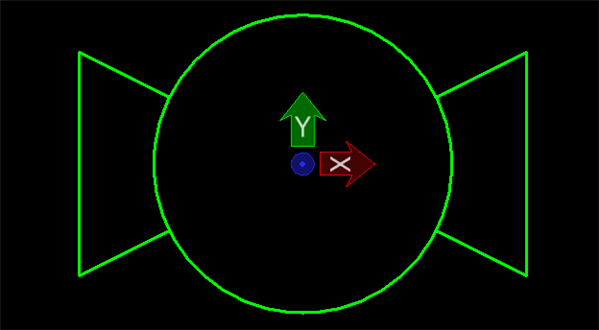

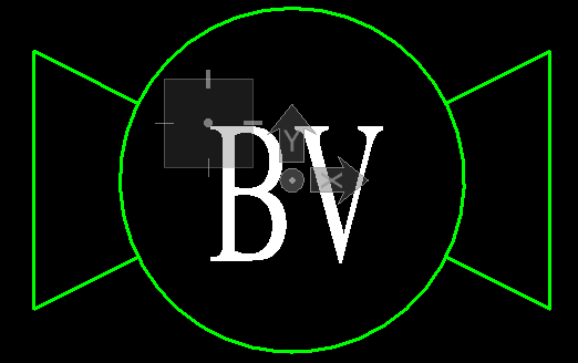

    • Go Model and open HVALVE_BALL_OPEN (Cell Name of Ball Valve).

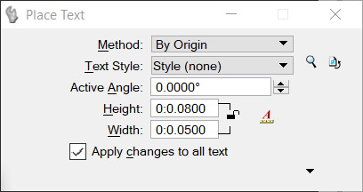

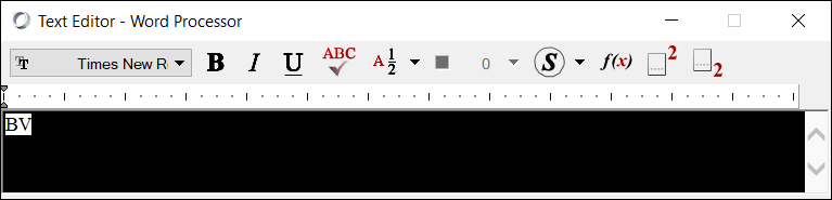

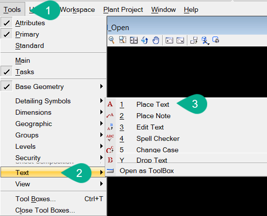

    • Go to Annotation, add text to graphics of ball valve in cell library.
    • click on Save and save settings.
    • Go to dgn file. Open key-in window.
    • Enter key-in – pid component redraw cells. In cell library, we have added the text annotation on ball valve. This change will show on existing ball valves in dgn file.
