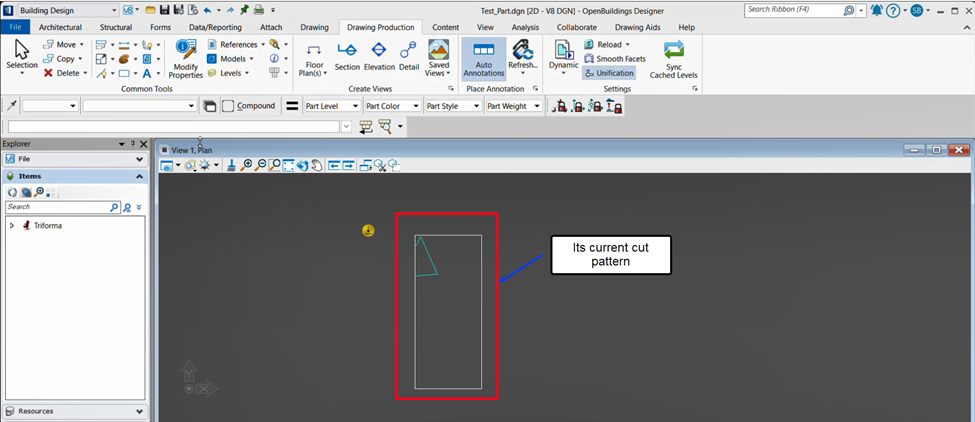

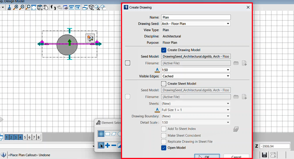

1. Place an element that has a Part/Family associated with it. Now place a plan on it so that we can see it present drawing symbologies.
2. In the plan view the current cut pattern will be shown.

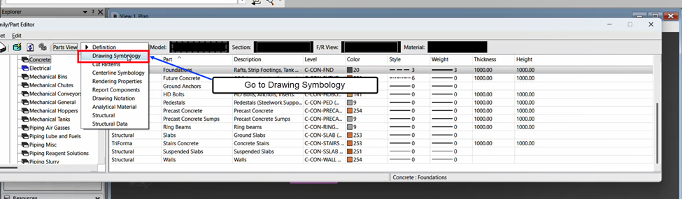

3. Now open the Part/Family editor and navigate to the associated Part/Family. Now, from ‘Parts View’ select ‘Drawing symbology’.
4. In ‘Drawing symbology’ change Level colour, Section Style, and Section Weight.
Now click on commit changes.

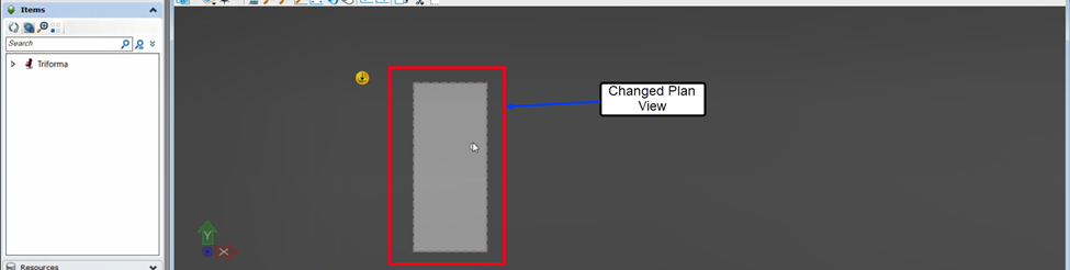

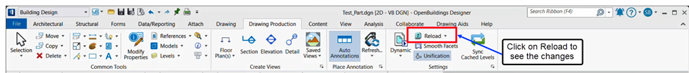

5. Now close the Part/Family editor and from the ‘Drawing Production’ ribbon click on ‘Reload’.
6. In the plan view it can be found the symbology has been changed.
