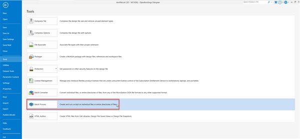

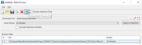

1. Go to Tools in the backstage and click on Batch Process

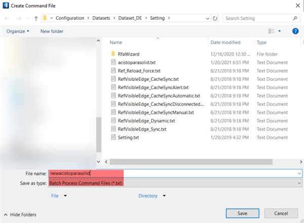

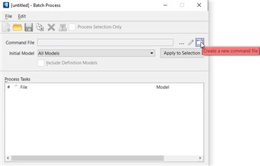

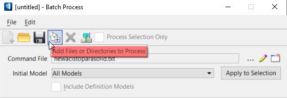

2. Create a new command file with .txt as an extension.

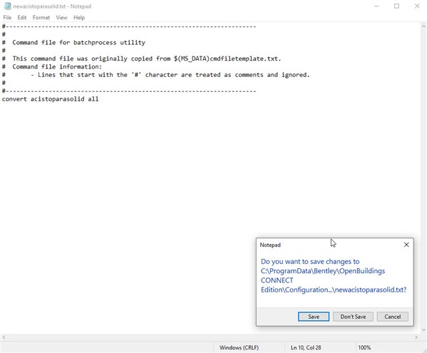

3. In the .txt file add the key-in "convert acistoparasolid all" and click on the save button before closing it.

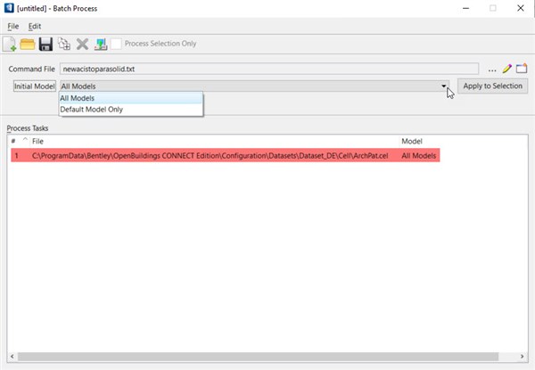

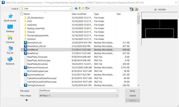

4. Select Add Files or Directories to Process
5. Select the desired DGN or CEL file. In this example, 'ArchPat.cel' is selected.

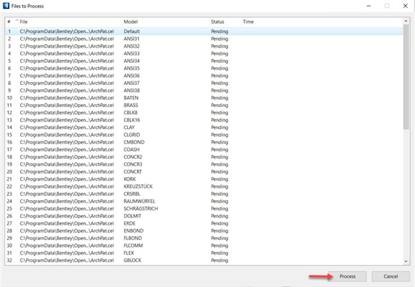

6. The Process Tasks window shows your selected cell library, but you can always attach more DGN or CEL files from the Add Files or Directories to Process command (ref to point 4) and change the type of model from the Initial model chosen.
7. Now click on the button 'Process Batch Process Job' to start the conversion.
