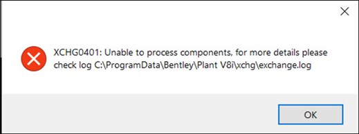

XCHG0401:Unable to Process Component Error Pops up while Generating the Isometric Drawing in AP_OPIM

While generating isometric drawing sometimes user may face below error for older drawing files in AutoPLANT Modeler CE. This error message generally pops when user tries to generate the isometric drawing for older AutoPLANT drawings V8i version.

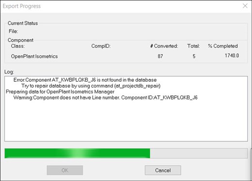

AutoPLANT 3D is very data-centric, and a drawing file can sometimes get out of sync with its database. The cause can be database failure/crashes, poor document management, and/or file system failures (requiring files to be recovered from whatever form of backup is used).
This wiki articles explains steps to resolve this issue.
Steps to Resolve
1.Open the drawing file in AutoPLANT Modeler Session
2.Run (at_projectdb_repair) command to repair and recover the database.
Note: Run this command along with the bracket
3.After repairing the drawing file, user will be able to run the isometric drawing without any issue.
