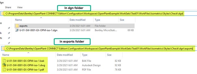

  7. Select the correct style & click on output format. Check-on the boxes & save. Attached the snap below for the same.
  8. Click on start. Once done, do right click & open containing folder as shown
  9. Once the folder is opened, notice that dgn is placed as shown in step-7. To see the various output format files, open the exports folder & check whether all format is created as desired.
