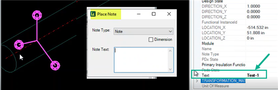

In OpenPlant Isometrics Manager CONNECT Edition, Note is placed along with the text associated with it. Refer the attached image below.
OPIM results
 The below wiki article explain how to attach a detailed sketch along with the text Test-1 as shown above.

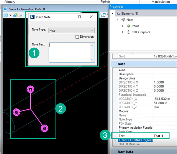

  1. In OpenPlant Modeler, place a piping arrangement > Place a note on it & enter any desired text to it. ( here as Test-1)

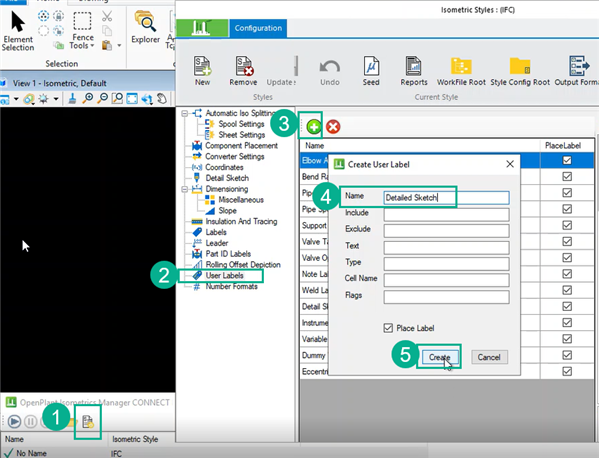

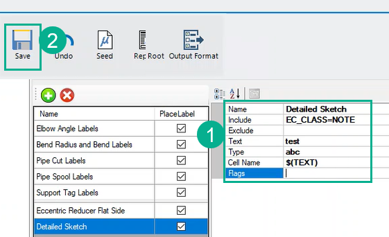

  2. Launch style configuration.
  3. From User label, add a new label from user label as shown
  4. Enter the fields as shown
    Note: Here EC_CLASS name for Note is NOTE. For a different types of notes, one can enter the particular EC Class name.

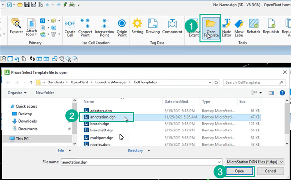

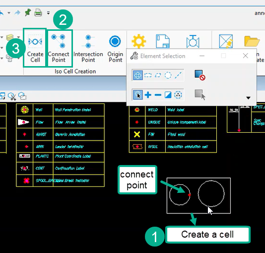

  5. Now, to create a cell of sketch, click on open template & open annotation.dgn as shown.
  6. Create a cell as desired > mention the connect point > Select the whole assembly > Click on create cell as shown

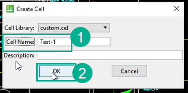

  7. On the dialogue of cell creation, enter the details for cell name exactly same as the text placed in step-1. It will not read if there is change in the name.

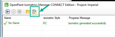

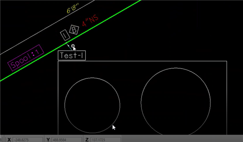

  8. Close the isometric application/dgn & regenerate the isometric.

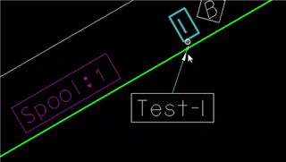

  9. Notice that, the sketch is now placed along with the  note as shown
