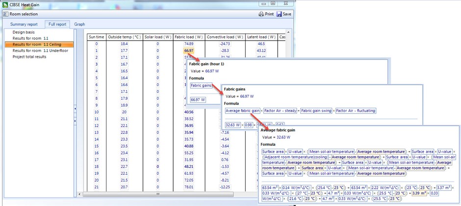

OpenBuildings Energy Simulator calculation results can be investigated by simply left-clicking on each value in the report. This will display all related equations and figures used to arrive at the final result, right back to basic principles.

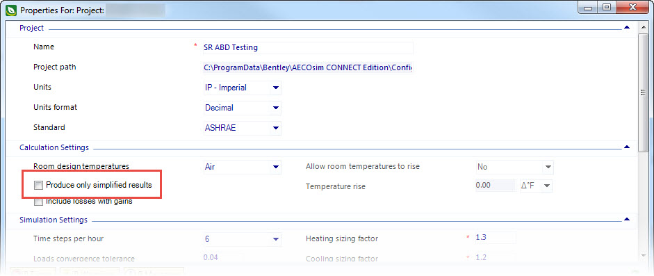

To enable this function, right-click on project in the Project Tree and choose Properties from the pop-up menu:
Then, disable the option to Produce only simplified results, as below:
