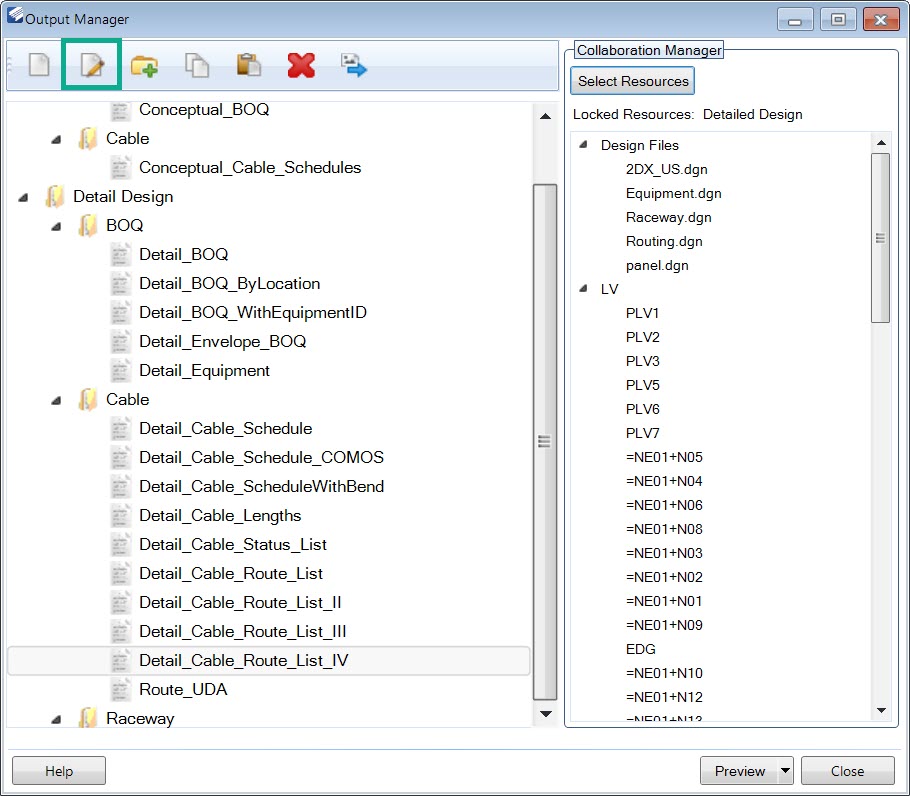

  1. Launch BRCM and open any file from the example project.

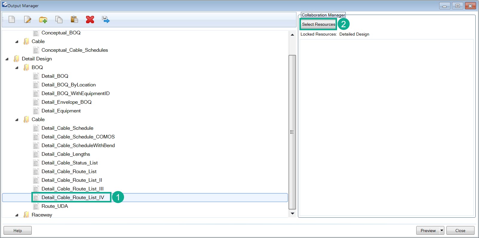

  2. Open Output Manager from Output ribbon menu.
  3. Open Cable Route List IV and Select Resources.

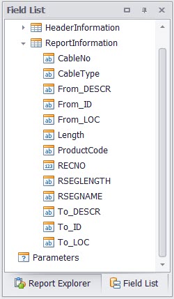

  4. Click on Edit Report Template to launch the Report Designer.
  5. In Report Designer’s Field List section, you can see that the imported UDA is not in the Report Information list.|

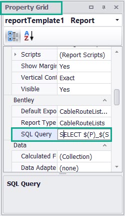

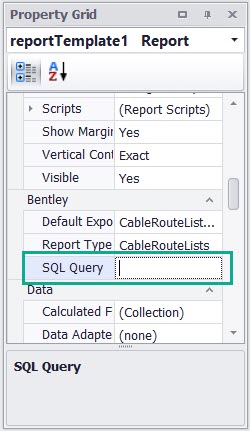

  6. Now, look for SQL Query in the Property Grid section and copy it.

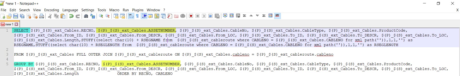

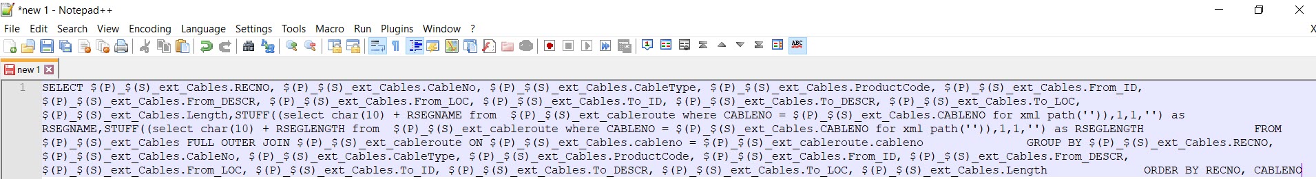

  7. Open any preferred text editor and paste the SQL Query.
  8. Make an entry for the Cable UDA as $(P)_$(S)_ext_Cables.UDANAME in SELECT and GROUP BY.
    For Example: $(P)_$(S)_ext_Cables.ASSETNUMBER.
  9. Now go back to BRCM, paste the edited SQL query, and save the report.

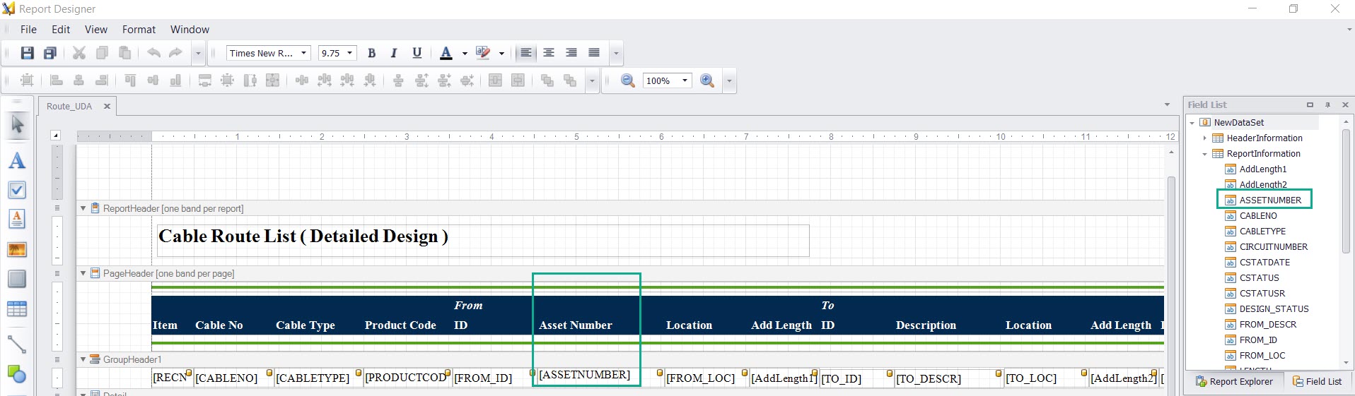

  10. Close and reopen the Report Designer and you will find the Cable UDA in the Field list.

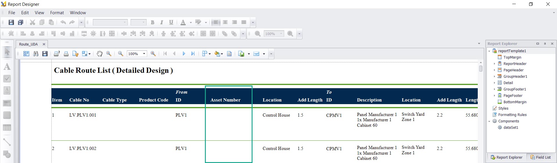

    Drag and drop the new field list in your report as shown in the image below.
  11. Preview the report and you will get the Cable UDA values under the header.
