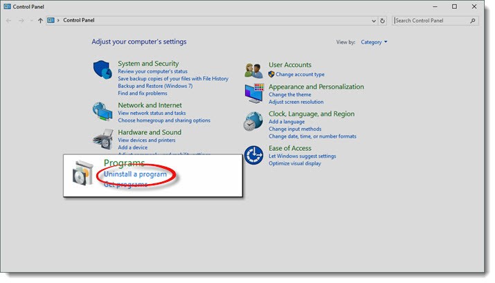

1] From the Control Panel, select Uninstall a program
2] From the list of available programs, uninstall all components that reference Bentley OpenBuildings Designer.
