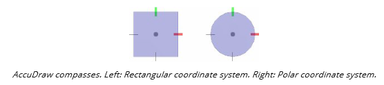

AccuDraw's most recognizable feature is its compass, visible only when AccuDraw is active and has control of OpenBuildings Energy Simulator’s coordinate input, the compass acts as both a status indicator and a focus for your input.
When AccuDraw has focus, its compass has a transparent blue background. When it does not have focus, the compass appears grey.
AccuDraw has two modes rectangular coordinate mode and polar coordinate mode.

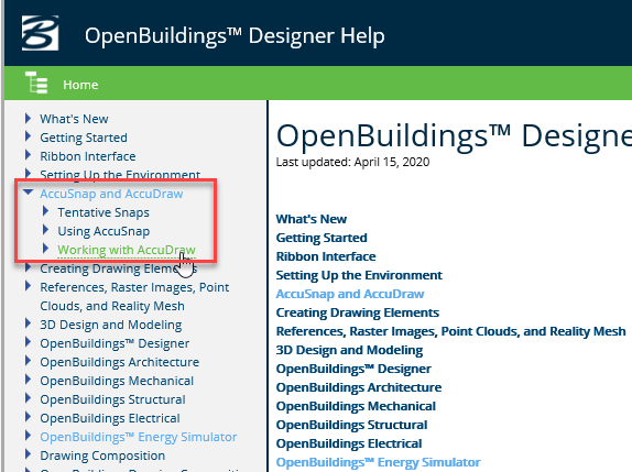

For more detailed information on the above, such as AccuDraw shortcuts, and how to rotate your compass, please go to the Help contents: Home > AccuSnap and AccuDraw.
