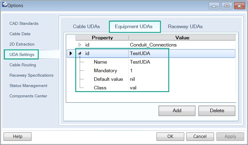

  1. Define Equipment UDAs which you want to export in reports.
    For example:

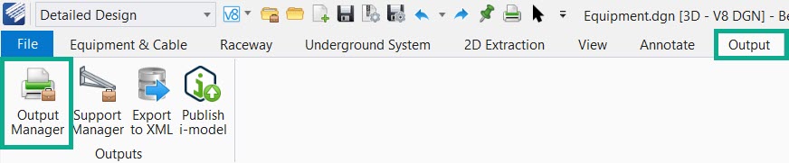

  2. Open Output Manager from Output ribbon tab

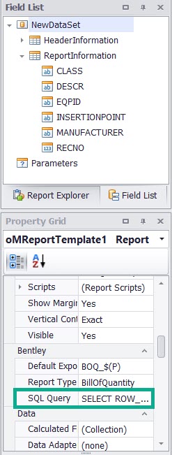

  3. Select the Detail_Equipment report, select the resources and open Edit Template.
  4. Copy the SQL query as shown in the image below:
    “SELECT ROW_NUMBER() OVER (ORDER BY EQPID) AS RECNO, * FROM (SELECT distinct CLASS, MANUFACTURER, EQPDESCR AS DESCR, EQPID, INSERTIONPOINT FROM $(P)_$(S)_EXT_BOQRW WHERE CLASS = 'EQ') CEQP;”
  5. Enter the UDA as shown:
    SELECT ROW_NUMBER() OVER (ORDER BY EQPID) AS RECNO, * FROM (SELECT distinct CLASS, MANUFACTURER, EQPDESCR AS DESCR, EQPID, INSERTIONPOINT, TESTUDA FROM $(P)_$(S)_EXT_BOQRW WHERE CLASS = 'EQ') CEQP;
    Add the query in the SQL Query section from where it is copied, save the template and close BRCM.

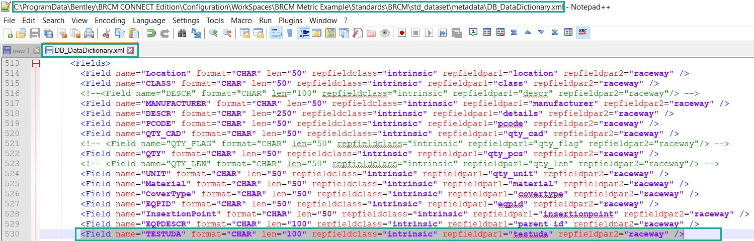

  6. Open DB_DataDictionary.xml from the std_dataset’s metadata folder. Add a new entry and enter your UDA name as shown in the image.

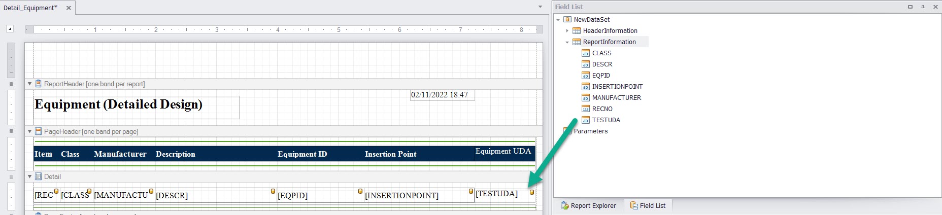

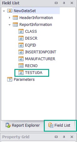

  7. Relaunch BRCM and open the Detail_Equipment report template. Now you will see a new field list as your UDA name.
  8. Drag this new Field List and place where you want to see the UDA in the report template.

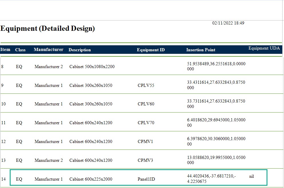

    For example:
  9. Save and run the report.
