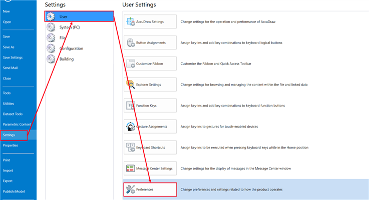

When launching OpenBuildings Designer the ‘Element Selection’ dialog always appears. This is because the ‘Selection’ command is chosen as the ‘Default Tool’ in User Preferences. But this default setting can be changed using the steps below.
1. Open a DGN file in OpenBuildings Designer. Then open the ‘Preferences’ dialog by choosing File>Settings>User>Preferences:
