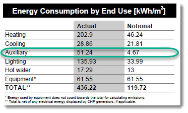

The 'Energy Consumption by End Use' section of a Compliance Report can be a useful tool in pinpointing the reasons for a poor energy rating. While Heating, Cooling, Lighting and Hot Water categories are largely self-explanatory, Auxiliary Energy can appear slightly ambiguous.

Controls, pumps and fans throughout the building will determine the Auxiliary Energy result. It is dependant on numerous factors, including:
