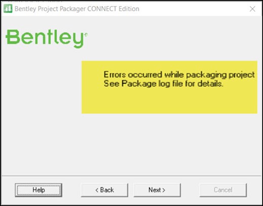

After creating project package through Project Packager, some times user may below error while unpackaging this project in other machine.
This wiki article explains the steps to resolve this issue.

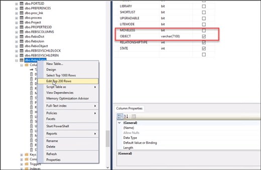

This issue happens when user create the AutoPLANT Project package with SQL database and tries to unpackage the same project in other machine with Access database. While investigating log file noticed that problem arise because of the field length value. It was mentioned beyond the limit in SQL database. Ideal Varchar limit is 255 for Access database
Check the error mentioned in below log file. Check the log file at the below directory.
C:\ProgramData\Bentley\Plant V8i\Packager\LogFiles
Steps to Resolve
1.Open the SQL database
2.Check the table mentioned in the log file.
3.Modify the Var char value for the table. It should be upto 255 length for Access database.
4.After correcting  all the field, create the Project package and unpackaging work properly.
