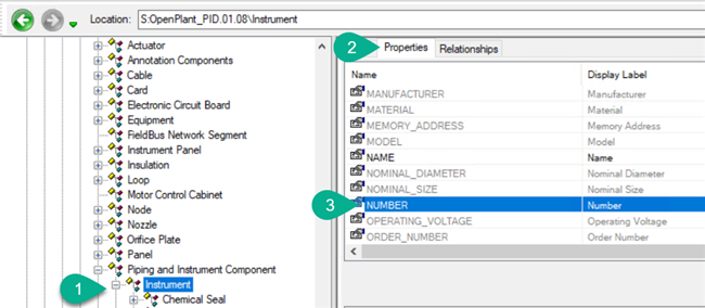

  3. Navigate the Instrument Class. Switch the property Tab and select the Number property as shown below

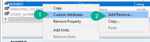

  4. Right-click on the Number property and click on the add-remove custom attributes. Refer below image

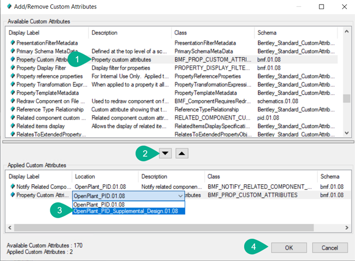

  5. Add Property Custom Attribute and using the down arrow add this custom attribute. Ensure to change schema location for this applied custom attribute as shown below.
  6. Save all the schema changes. Verify the results in OpenPlant PID.

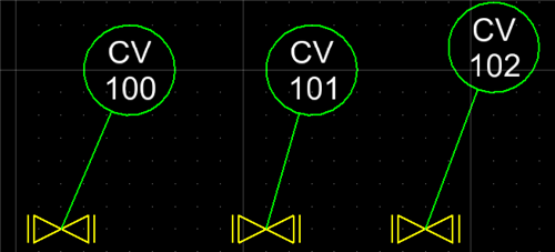

  7. Place the first new control valve in a new P&ID in the project. Once this is set the user will have to place the first valve and set the number to 100. After this is done every valve placed after this will automatically increment to the highest number – so Valve 1 = 100, Valve 2 when placed will be 101, and so on.
