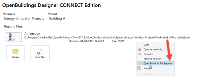

  1. Exit OpenBuildings Energy Simulator
  2. Use file explorer to navigate to your Worksets folder. Should you be unsure of the exact location of your Workset folder, then the path will be listed when you open OpenBuildings Energy Simulator as in example below. You can right click as below to Browse to the location.

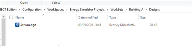

  3. This will take to you to the encompassing Workset folder:

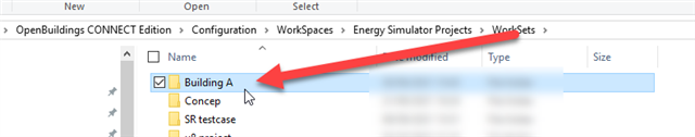

  4. Navigating up will bring you to the Workset folder itself. (This will contain at a minimum the Designs, Output and Standards folders - these are all required).
  5. Browse to the Workset folder, and copy/zip this using Windows zipping tools, or you may wish to use other 3rd party software such as WinZip or 7zip.

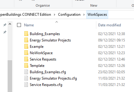

Alternatively, for several projects, you can retrieve the associated Workspace as follows:
  1. As above, navigate to the project location.
  2. Navigate up to find the encompassing Workspace folder:
  3. The folder required in this instance is the "Energy Simulator Projects" folder. Copy/zip this, along with the related configuration file:
