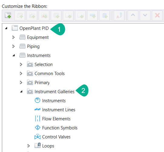

  3. Under Customize Ribbon dialog, from right hand pane (Customize the Ribbon section). Expand OpenPlant PID node and further expand Instrument Galleries. Refer image below

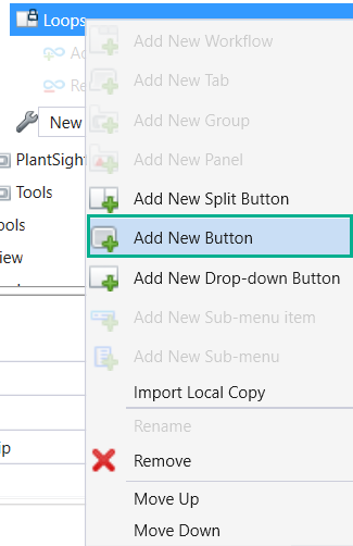

  4.  Right click on loop node & select Add New Button as shown below.

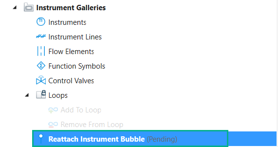

  5. Enter desired button name Reattach Instrument Bubble hereRefer image below.

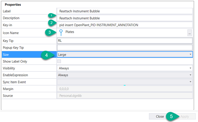

  6. For added button, from Properties, AddDescription asReattach Instrument Bubble and define pid insert OpenPlant_PID INSTRUMENT_ANNOTATION key-in.
  7.  Select Size as Large & click on Icon Name to define your custom icon. Click on Apply Refer image below

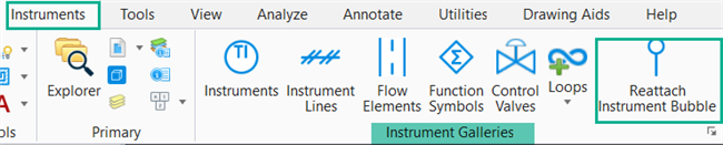

  8. In Instrument galleries ribbon group, this add the new icon in the ribbon “Reattach Instrument Bubble” as shown below

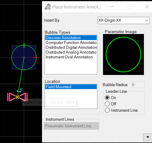

  9. Click on the Reattach Instrument Bubble ribbon tool and it will prompt you the same annotation reattach the instrument bubble window
  10. Verify the result.
