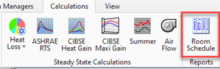

OpenBuildings Energy Simulator allows you to easily review all the surface and construction data related to your building model. This can be used to:
Method

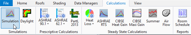

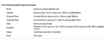

Under Calculations, Room Schedule will display all the surface data for your model.
Including:

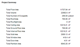

Should you require a more detailed breakdown of each room then this can be achieved by running a Simulation.

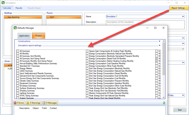

1.  You can specify the reports required by selecting Report Settings in the top right corner.

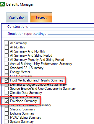

2. For a building data summary you may wish to select only the following reports, and more can be selected depending on your requirements:

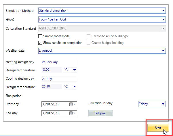

3. Click OK, and then Start any simulation:
4. Once complete, the Summary Results will be available as below:
