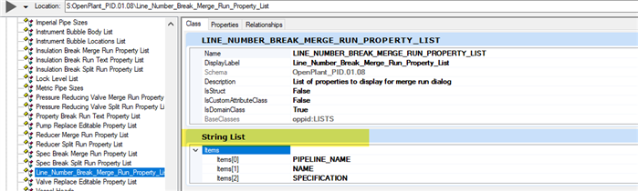

  5. Save the last changes done and go to List class (Type in Search ,”LISTS”and it will be directed to that class directly).
    Select,”SPEC_BREAK_MERGE_RUN_PROPERTY_LIST” and right click on it →Copy it →Paste it on List class directly.
    Rename new class as,” LINE_NUMBER_BREAK_MERGE_RUN_PROPERTY_LIST”.
  6. Similarly Select,”SPEC_BREAK_SPLIT_RUN_PROPERTY_LIST” and right click on it →Copy it →Paste it on List class directly.
    Rename new class as,” LINE_NUMBER_BREAK_SPLIT_RUN_PROPERTY_LIST”.
  7. Since LINE_NUMBER_BREAK_MERGE_RUN_PROPERTY_LIST & LINE_NUMBER_BREAK_SPLIT_RUN_PROPERTY_LIST  is copied from SPEC_BREAK_MERGE_RUN_PROPERTY_LIST & SPEC_BREAK_SPLIT_RUN_PROPERTY_LIST so the custom attribute String List will also be reflected but its location of schema  is not defined.
  8. Right Click on LINE_NUMBER_BREAK_MERGE_RUN_PROPERTY_LIST class →Select Custom Attribute→Add/Remove.
    Change the schema location from OpenPlant_PID. 01.08.ecshema schema to OpenPlant_PID_Supplemental_Design.01.08.ecshema and then click on Ok.
  9. After Schema location for String List is changes right click on Items and select Add Element.
  10. Add Into new added item(3) :LINE_NUMBER.
  11. Similarly change the schema location  for LINE_NUMBER_BREAK_SPLIT_RUN_PROPERTY_LIST ‘s String List custom attribute and add LINE_NUMBER into Items
