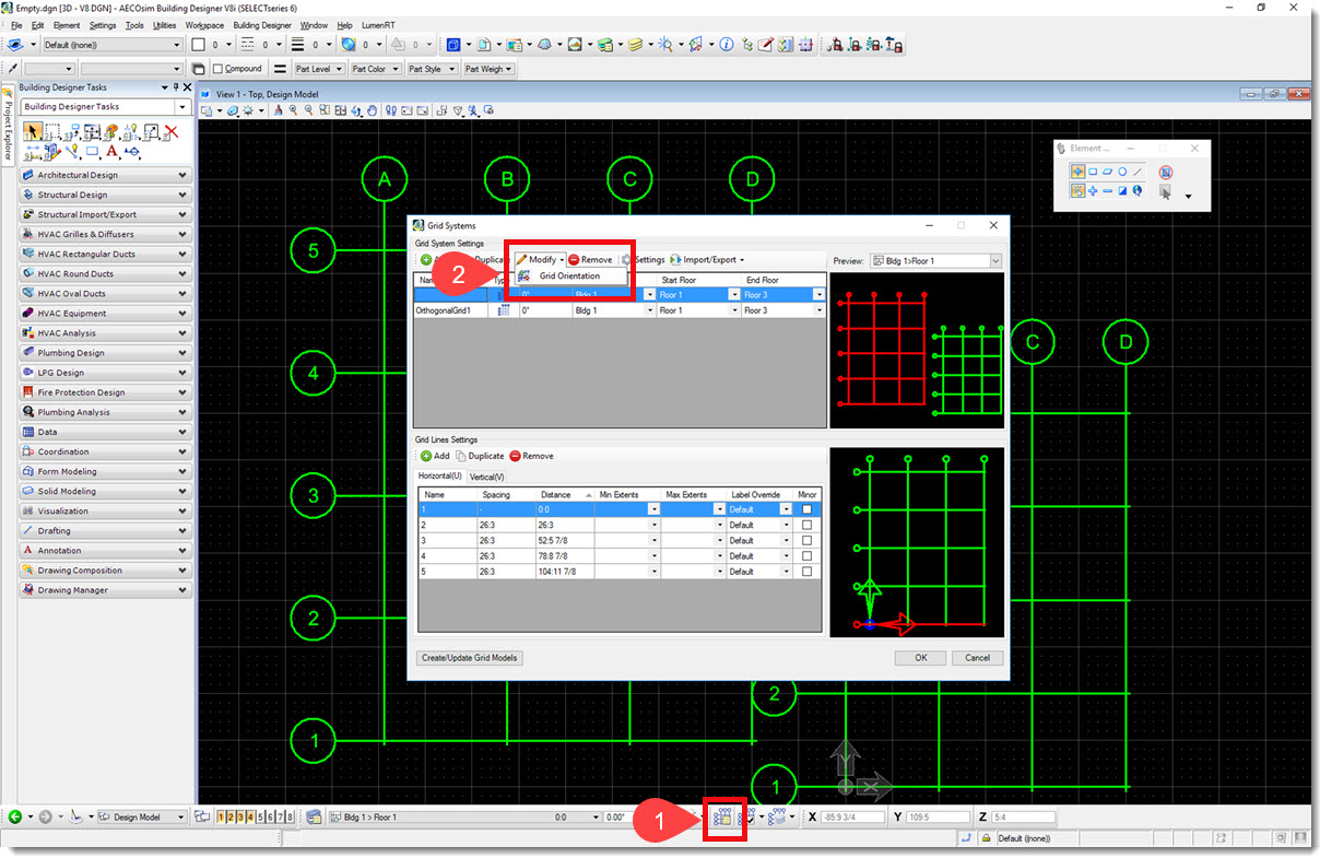

I placed Column Grid system in OpenBuildings Designer. How I can Move / Rotate Column Grid System?
Please go through the following steps to solve this issue,

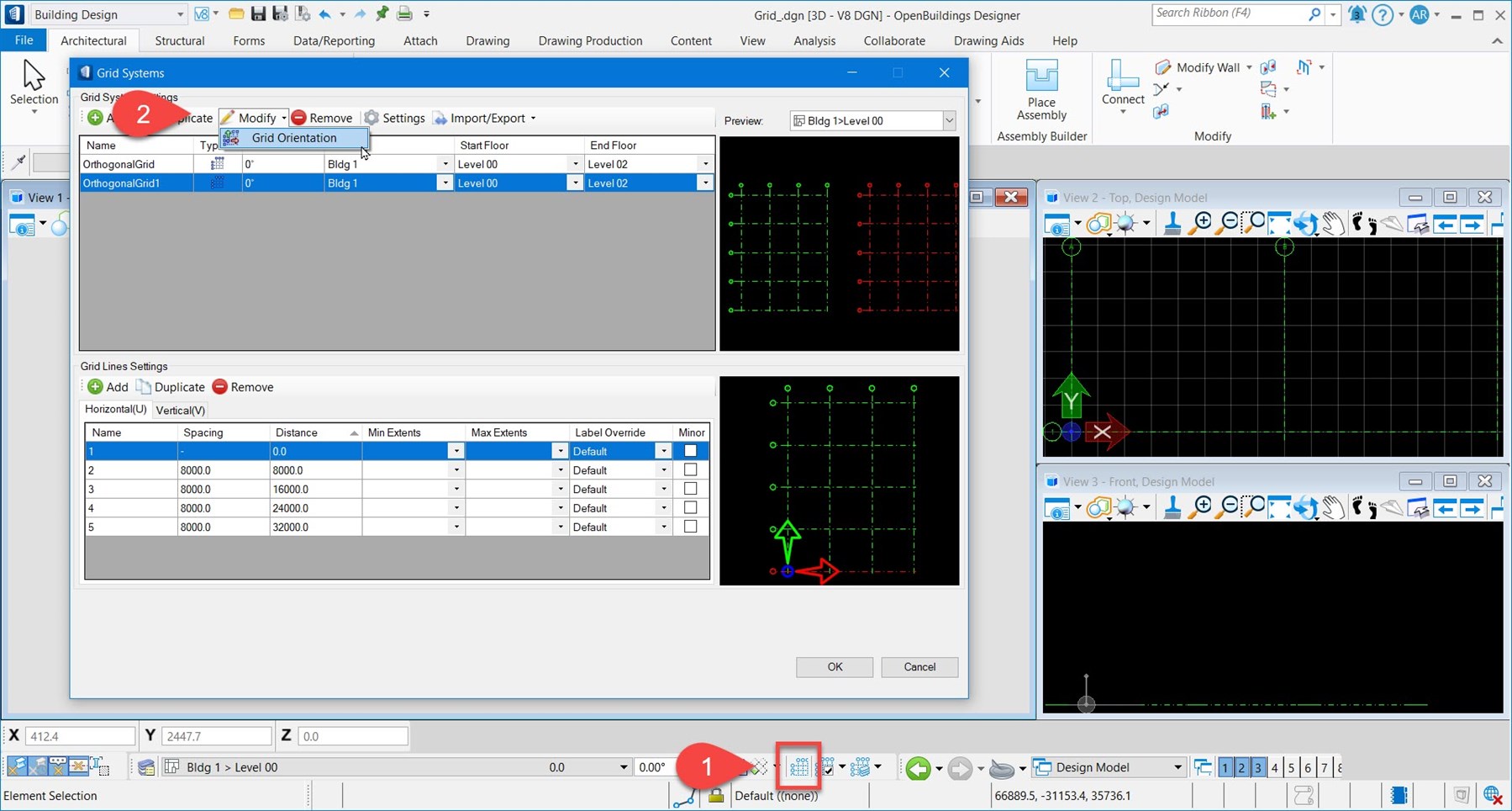

  1. After creating Column Grid system, open 'Grid System Manager'.
  2. Click on ‘Modify’ tab and ‘Select Grid Orientation’ option.

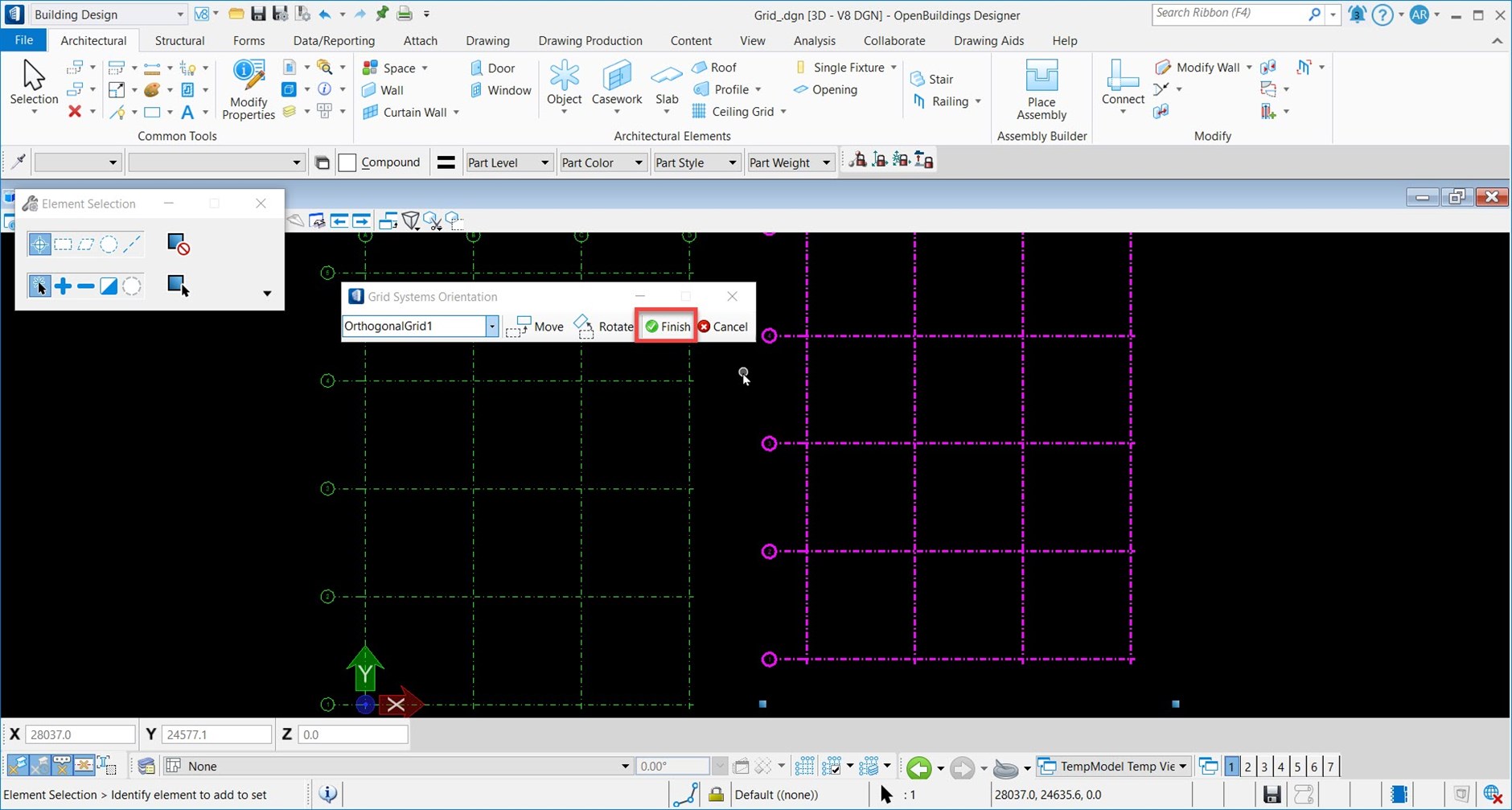

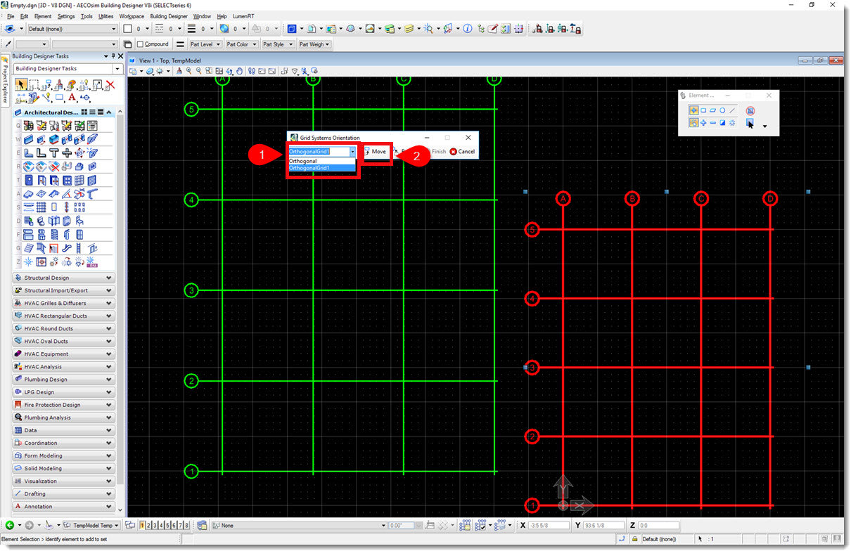

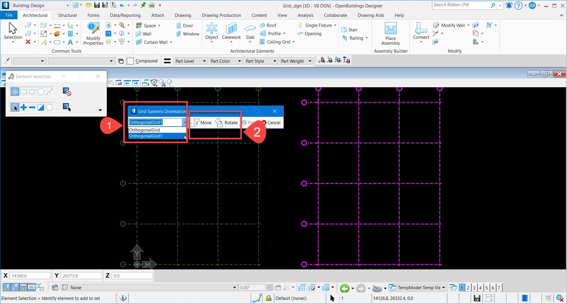

  3. Select required grid system and then select 'Move' option. Now select the Grid corner and move the grid system as you want.
    2nd Pic

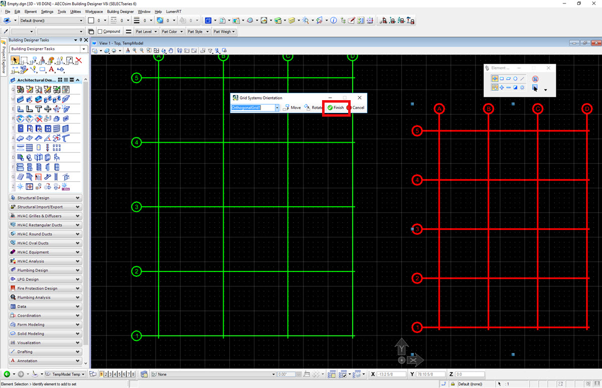

  4. Once you have done with moving, click on 'Finish'.
    3rd Pic
