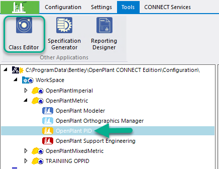

  1. Launch Bentley Class Editor CE .
  2. Bentley Class Editor can also be launched through OpenPlant Project Administrator CE.
  3. In OpenPlant Project Administrator, Click on OpenPlant PID application for the required project in WorkSpace and click on Tools. After clicking on OpenPlant PID, in Tools-> Class Editor icon gets enabled as shown in image below.

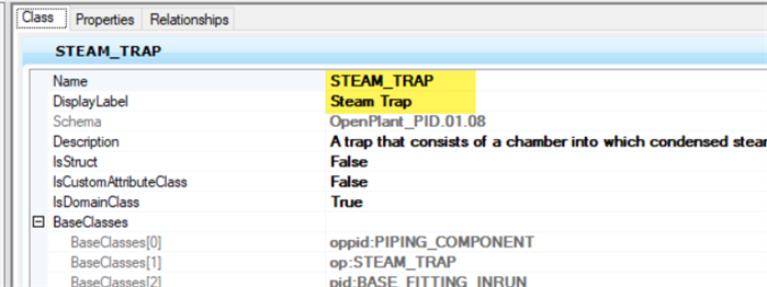

  5. Go to Steam Trap in Piping Component or type in search,”STEAM_TRAP”.

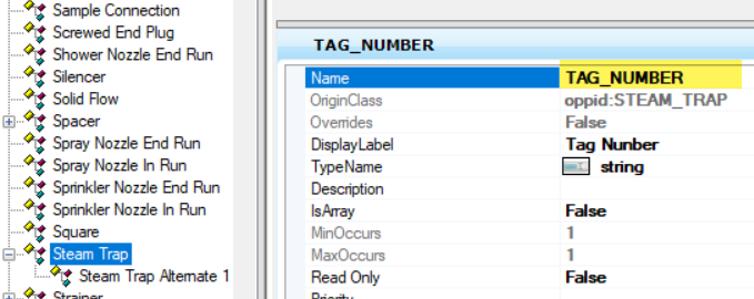

  6. In Properties Tab, Add new property TAG_NUMBER.
    Existing property -Name also be modified with override.

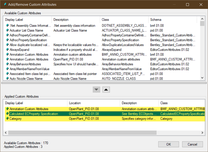

  7. Add below Custom Attributes in PIPELINE_TAG.
    -Annotation Custom Attributes.
    -Calculated EC Expression Specification
    -Category.
  8. In Applied Custom Attributes as it can be seen location of schemas being OpenPlant_PID.01.08 change it to OpenPlant_PID_Supplemental_Design.01.08 for all three custom attributes and hit on ok

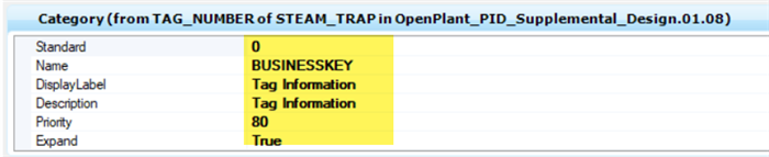

  9. Category custom attribute can be copied from desired other properties.Or it can be inserted into Tag Information section

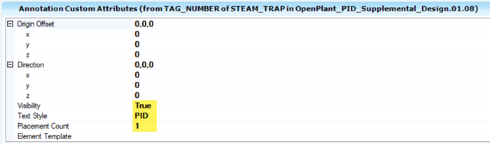

  10. In Annotation Custom Attributes make the below changes and as per the requirement keep the Placement as 1 or 2 .
    Depending upon the number the tag will displayed one after other.

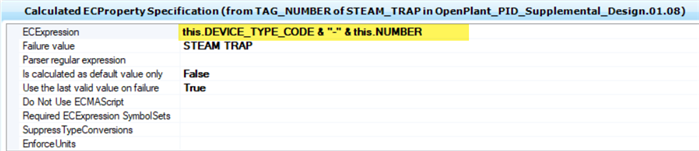

  11. Add "Calculated ECProperty Specification"custom attribute on it and add below EC Expression.
    this.DEVICE_TYPE_CODE & "-" & this.NUMBER

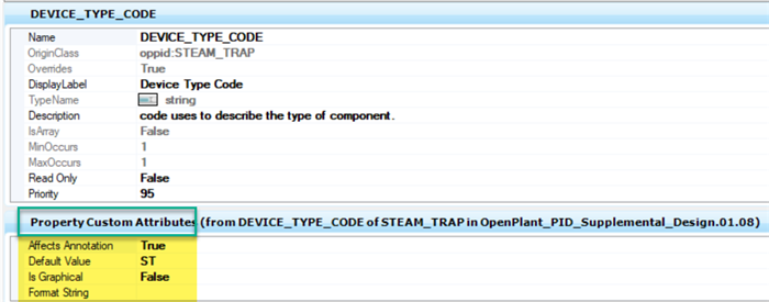

  12. Go to DEVICE_TYPE_CODE property -Override it and add new custom attribute-Property Custom Attribute and ST (Steam Trap) in Default Value as shown below.

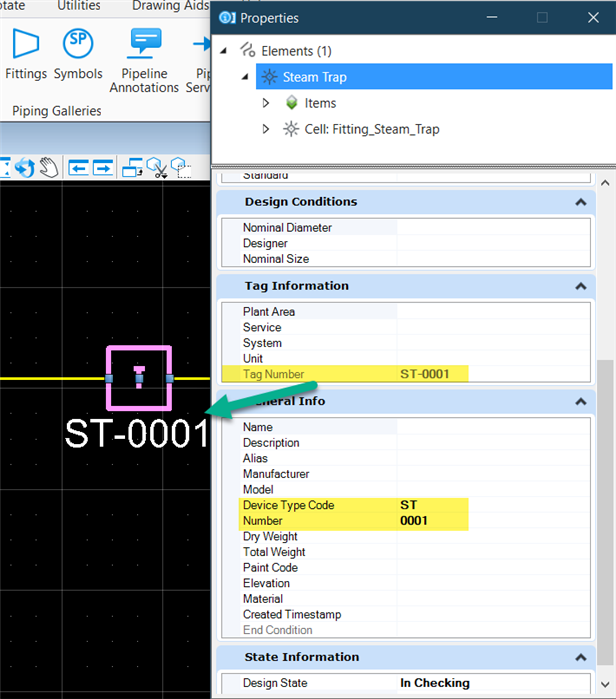

  13. Launch OpenPlant PID CE.
  14. On a Pipeline place Steam Trap through Keyin- ,”pid insert OpenPlant_PID STEAM_TRAP”.
    or through Piping→Fitting→Component Gallery→Steam Trap.
    Thus Steam Trap with along with Tag Number can be placed instantly.
