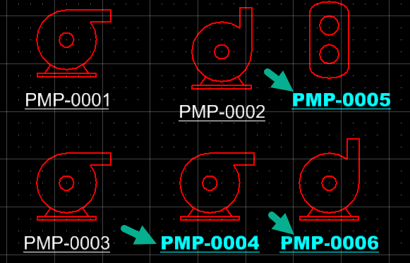

  3. Click on Equipment -Tab -A and place the Pump -B e.g Horizontal Centrifugal or Vertical Centrifugal -B  as shown in image below .
    Notice  Default Name of  Pump gets placed i.e PMP-0001 & PMP-0002 as highlighted below.

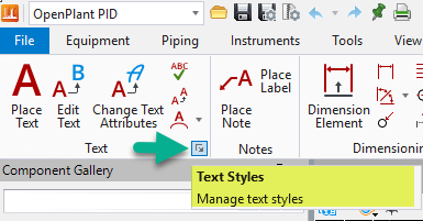

  5. In Text Ribbon Click on TextStyle as  highlighted  in below image to launch the TextStyle Dialog Box.
    (TextStyle can also be launched through typing in search Option in right Top corner)

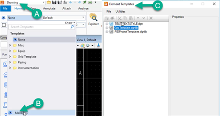

    In Dgn Change the Workflow to Drawing from OpenPlant PID- A, Manage in Text Ribbon - B & Element Template- C  dialog box gets open as shown in below image.

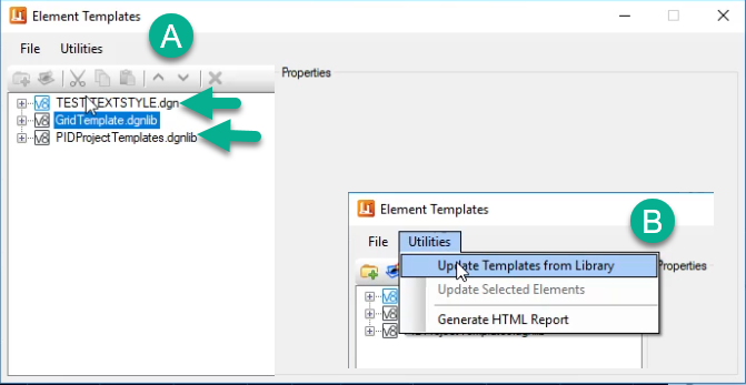

  12. In Element Template, Select the DGN-A which is created and PIDPProjectTempalte.dgnlib, Go to Utilities respectively and Click on Updates Templates from Library -B as shown below.

  14. With these changes even if user tries to  place the Pump, It will take default Textstyle like shown in below image.
  15. To get the new Textstyle i.e TEXTSTYLE-1 created gets reflected, Minor changes in schemas need to be done.

  18. Restart the OPPID and try to place the Pump, It can be seen that the Desired textstyle i.e TEXTSTYLE-1  gets reflected  while placing the Pump.
