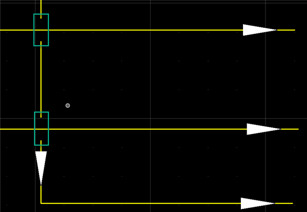

In OpenPlant PID, By default when two lines cross a gap is created. In this process you will modify the schema so that the jumper as shown in rectangular box used when two lines cross is an arc instead of the standard gap

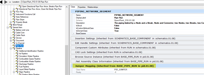

  4. In Piperun go to Jumper Mapping custom attribute.
    Presently it is inherited from BASE_PIPE_RUN from pid.01.08 schemas as highlighted below. So Class Name is Faded or greyed out.

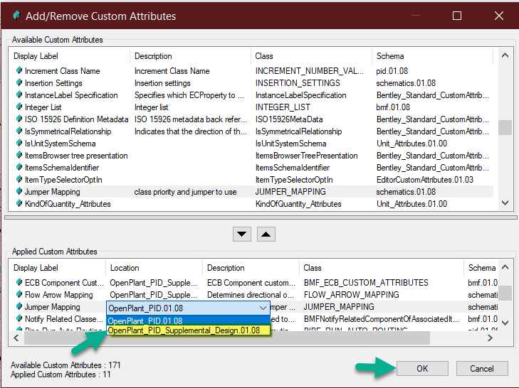

  5. Right Click on Class Piperun → Cutsom Attributes→ Add/Remove.
    In Applied Custom Attributes → Change the location of Jumper Mapping custom attribute from OpenPlant_PID.01.08 to OpenPlant_PID_Supplemental_Design.01.08 such that the changes in schemas would saved at project level itsel.
    Hit on Ok.

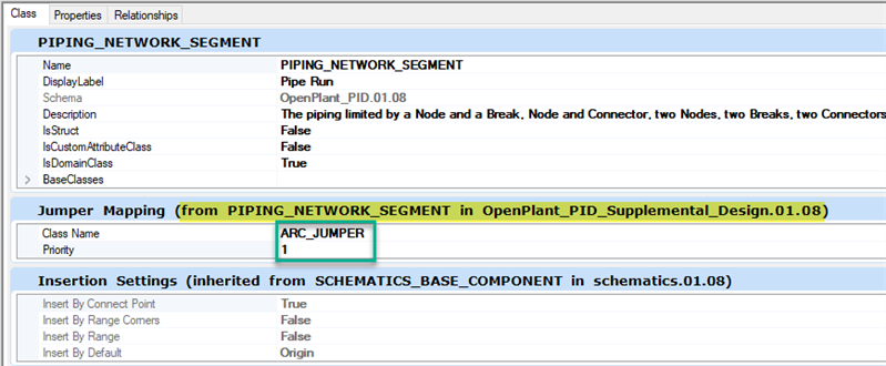

  6. In Piping Network Segment Class or Piperun now the Jumper Mapping custom attribute can be edited easily.
    Type in  Class Name type - ARC_JUMPER and Priority -1 as shown below.

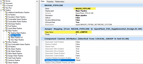

    Different Pipeline Classes use the JUMPER_MAPPING custom Attribute too. .

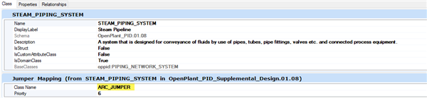

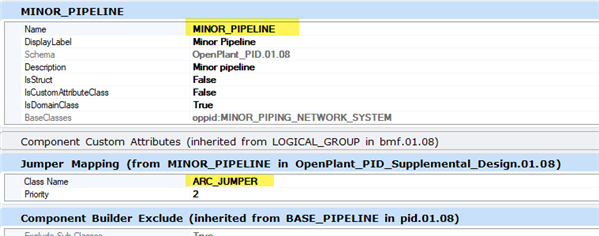

    Hence MAJOR_PIPELINE, EXISTING_MAJOR_PIPELINE, MINOR_PIPELINE, STEAM_PIPELINE by default is set to use standard PID_JUMPER .
    - If changes are not reflected while placing Major, Minor, Steam Pipelines, then go to same schema and select on each of those classes
    - Change PID_JUMPER to ARC_JUMPER on each class jumper Mapping custom attribute same like for PIPING_NETWORK_SEGMENT and save the changes
    For Major Pipeline
    For Minor Pipeline
    For Steam Pipeline
    Save the changes made in all Pipeline and start the OPPID CE.

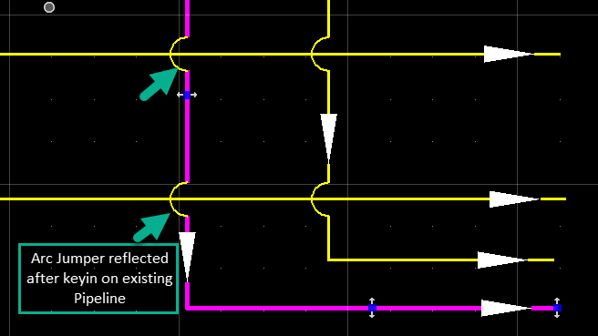

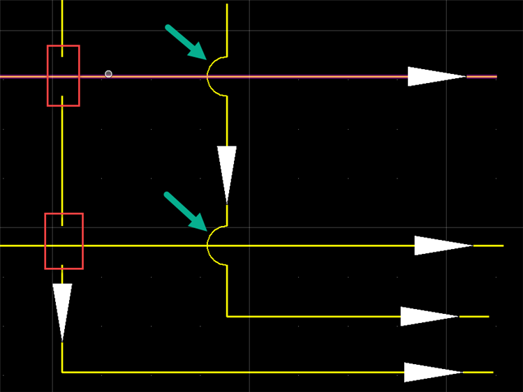

    1. Launch OpenPlant PID CE.
    2. Place a New Major Pipeline on same placed Major pipelines.
      As it can be observed  that Arc is getting placed instead of gap as shown in arrow. But the same need to be placed for existing Pipeline as shown in red box in image below.

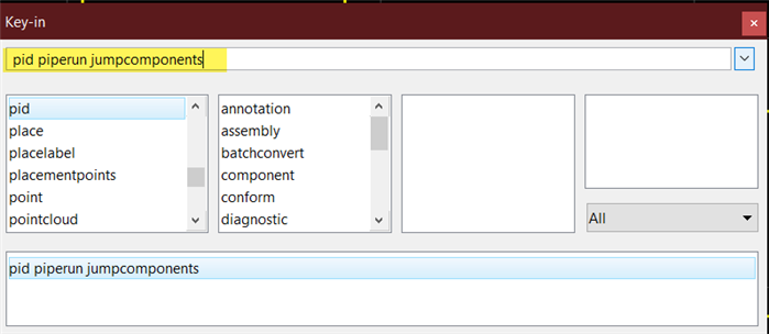

    3. To bring the ARC_JUMPER into an existing pipeline, hit enter such that keyin dialog box would be enabled. Select the Existing Pipeline on which Jumper need to be reflected and type in Keyin
      Keyin -, “pid piperun jumpcomponents & hit Enter.
    4. After hitting enter automatically on existing Pipeline the Arc Jumper gets reflected easily.
      Thus changing Jumper from Gap to Arc based user requirement.
