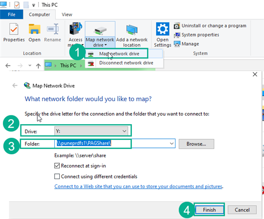

  1. Open Windows Explorer and map desired network drive as shown
  2. Network drive is now added as shown

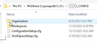

  3. Open the configuration from a network which needs to be set as default. Please see the attached image below
  4. Copy the Path "Y:\ABCD_CONFIG".

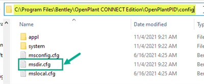

  5. Open msdir.cfg file in a notepad. File is located in "C:\Program Files\Bentley\OpenPlant CONNECT Edition\OpenPlantPID\config" folder.

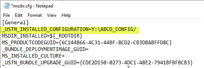

  6. Paste the copied path of the mapped drive as shown
    Note that, backward slash " / " is important at the end.

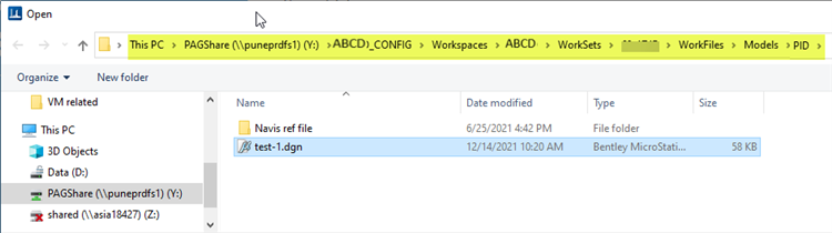

  7. Save the changes and launch OpenPlant PID to verify the result.
    Notice that, application is pointing to the network path as set.
